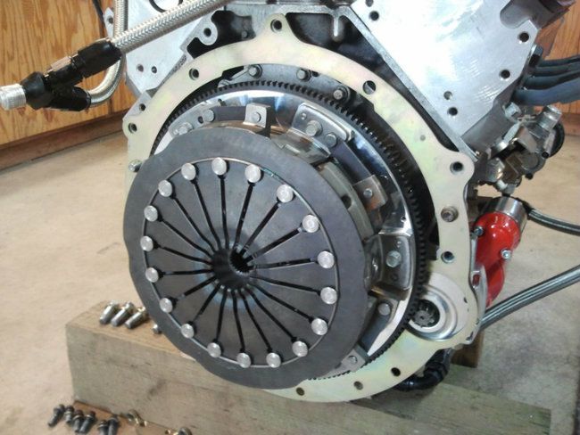

I'm starting to gather the parts for the transmission swap. I just received the new Tremec T56 Magnum today. For the flywheel and clutch I'm using a Katech aluminum flywheel, and a GM ZR1 Corvette twin disc clutch (modified for 20% increased grip). The Z-bar mechanical clutch linkage will be replaced with a hydraulic GM unit.
Got on a waiting list in mid December and received my transmission today
T56 Magnum close ratio. 2.66 first gear.
Corvette ZR1 twin disc clutch. This is the best clutch I've ever used.. great grip and very smooth engagement.

Nice pieces, did you buy just the flywheel from katech or the whole clutch/flywheel set up?
I am sort of kicking tires on different clutch setups at the minute.

I bought the parts together as a package... ZR1 clutch, aluminum flywheel, slave cylinder, and hardware. I drive the car a lot on the street and was looking for something with smooth engagement... this is it. The clutch is very smooth, no rattles and has a 960 Lb-Ft torque capacity. (i bought the kit with the extra 20% capacity)
