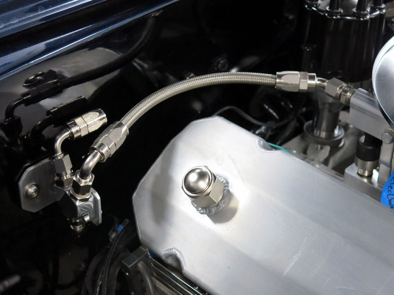

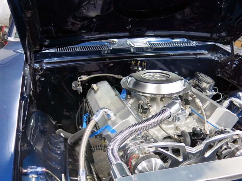

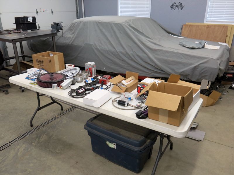

Update time. Spent half of Thursday and the majority of Friday working on the car.
Started by laying out the bulk of the parts left to install and typed up a list of “needed to run” items to prioritize my work.
I spent most of my time laying out the fuel system. Got the front/return lines ran to the regulator. The return line will also flow thru a cooler I mounted in front of the radiator.

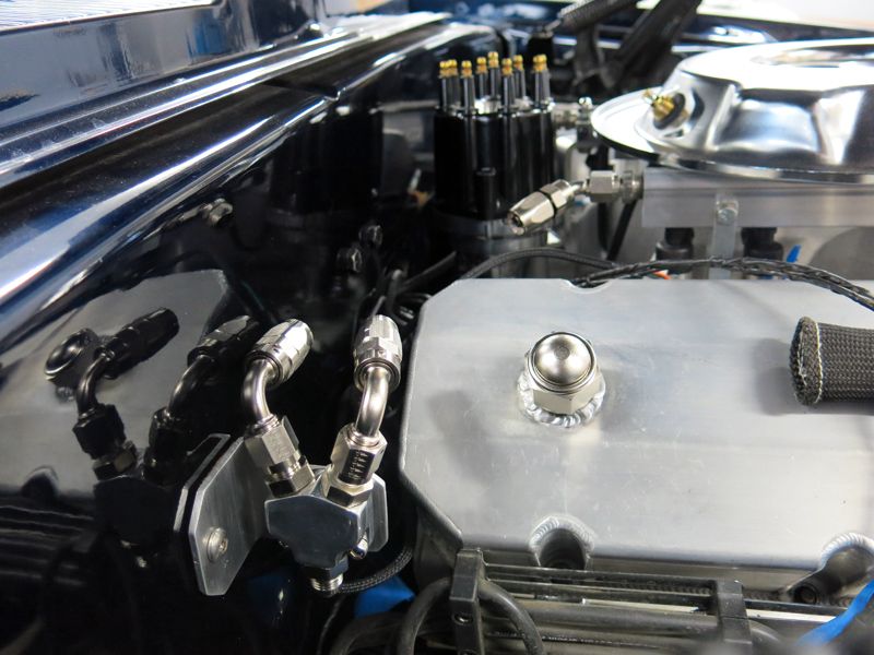

For the feed side I struggled with what to do with the y-block. I ended up making a little bracket that re-uses one of the holes from the previous coil installation. I may move it lower so the lines hug the top of the valve cover. I need to figure out where to mount the MSD box and coil so I can finish routing the feed line.
After the fuel lines are done I will focus on the electrical system again. Need to get power to the Holley ECM, fuel pump relay, & Vintage Air unit. Then it’s on to a few exhaust updates before changing fluids and pre-fire inspection.

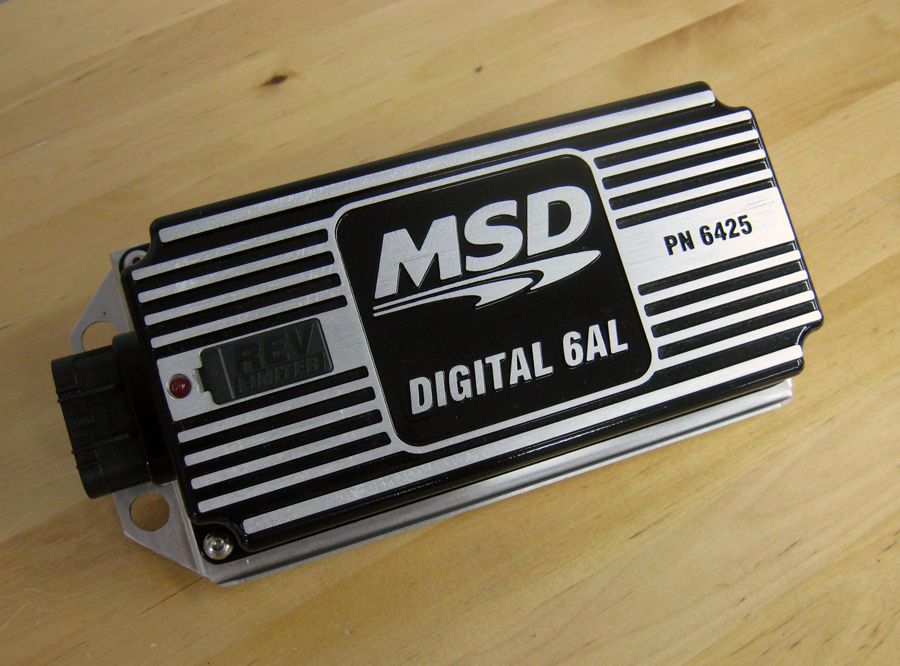

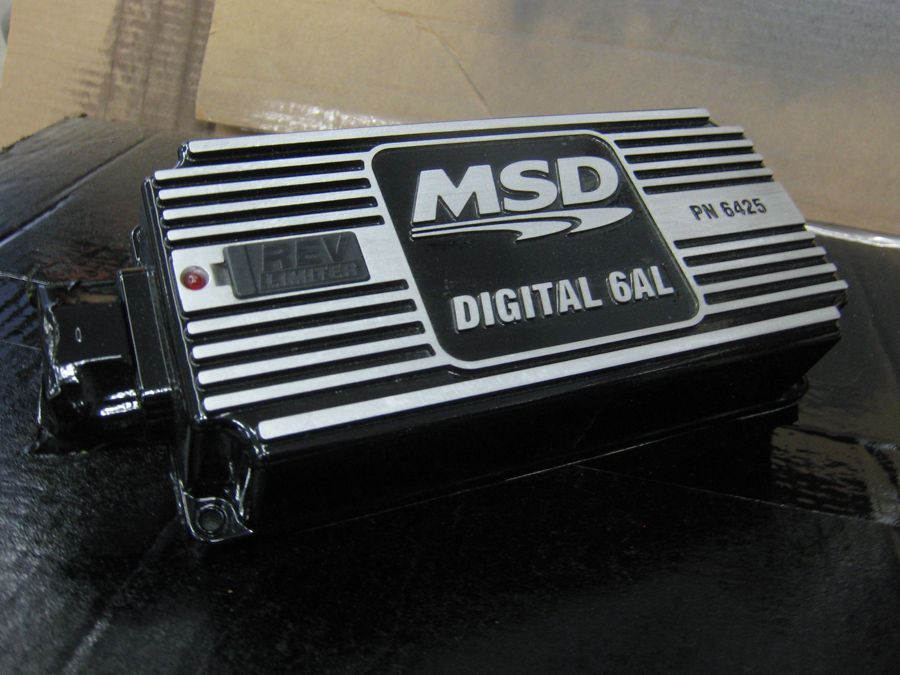

Painted our MSD box with a black rattle can kitchen appliance enamel. Seems like a nice durable finish. I roughed up the factory red with a scotch bright pad before painting. After the black dried I hit the high spots with a palm sander to bring them back down to aluminum. Time to clean it up and get it mounted.

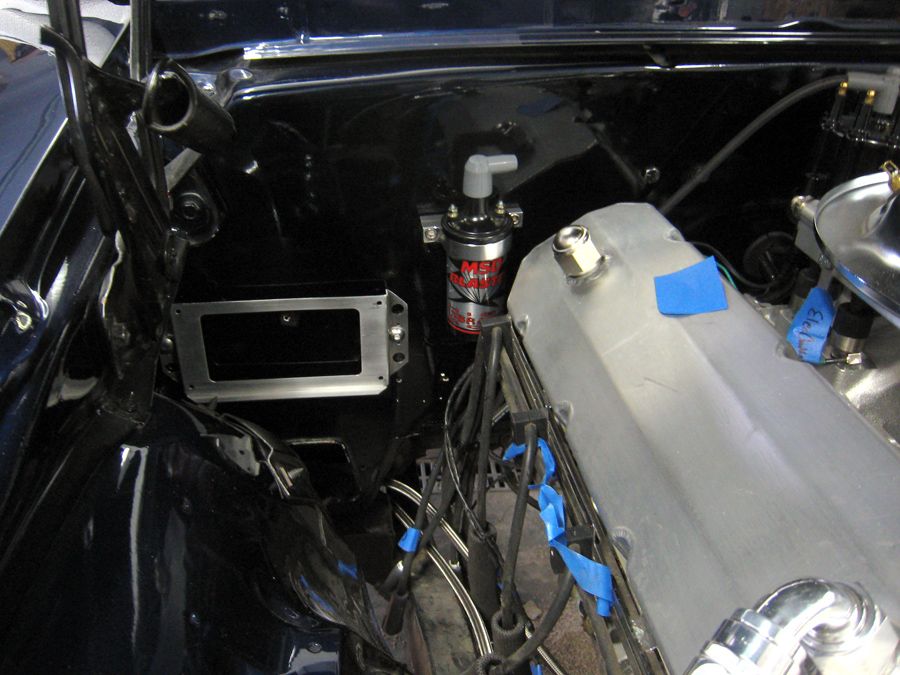

Been trying to reuse or cover up old holes in our smoothed firewall. Found that a 2.125" billet fuel filter bracket works great for a coil mount. Even the holes matched up to the old chrome bracket. I also did a little trimming to clean up the MSD mounting bracket.

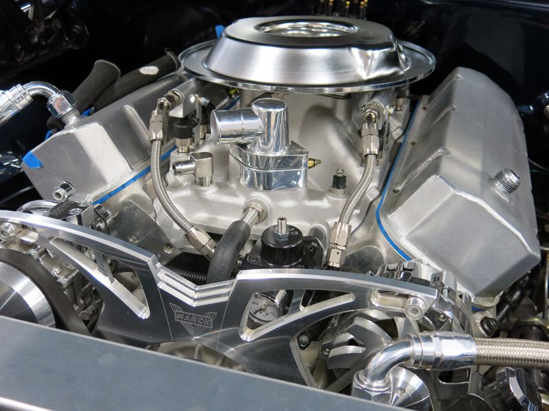

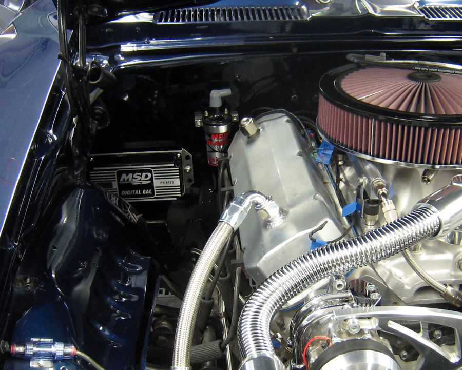

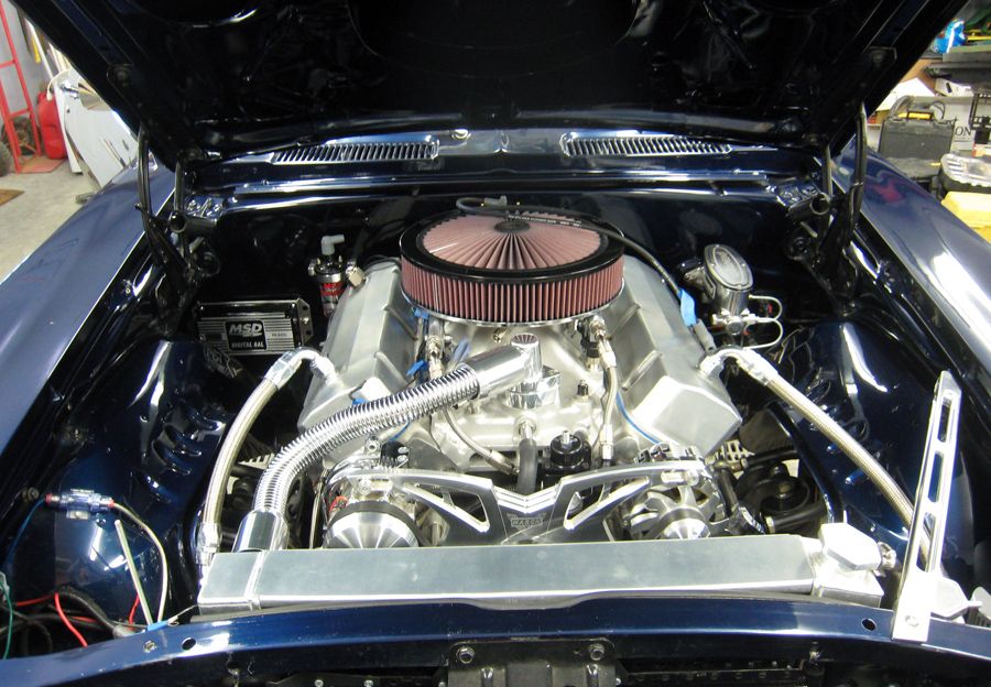

Had a little time this afternoon so I got the MSD box mounted to it's bracket and then to the firewall. I also played around with options for my fuel supply and made a shopping list for fittings needed to finalize it. I originally had the regulator mounted off the intake behind the pulleys. I don't like where the return line runs in this setup so I'm going to reverse things and borrow Chris's idea on where to mount the regulator. This will work better with the cooler I'm mounting in front of the radiator as well.
