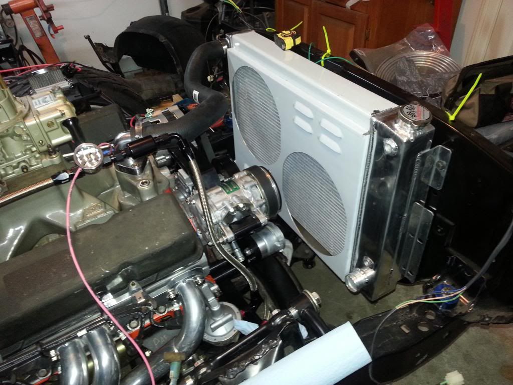

New parts came today
The excitement was somewhat tempered when I realized the magnaflow exhaust was 2.5" and my collectors were 3". Details details... nothing 125 dollars won't fix.
Here is the radiator test fit
