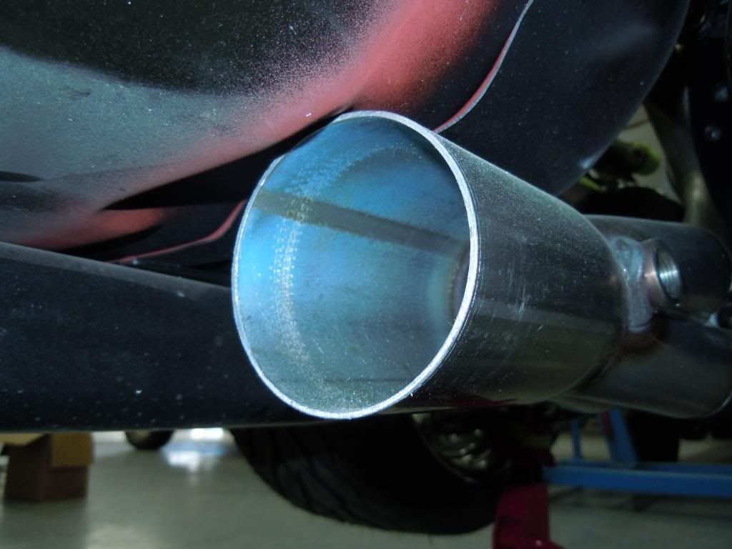

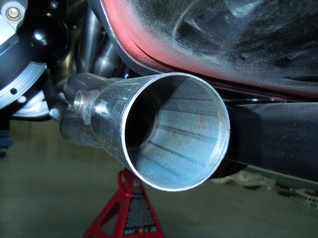

OK, we ran into problems. Running the half height body mounts the headers hit against the bottom of the car. And with regular height body mounts you will only gain 3/8 of an inch clearance where you might have problems with the clamps. Here's a couple of pics.

What's your drive-train angle? Can you lower the rear of the trans and still have 2* to 3*?
3 degrees. It's where Dan says it need to be.

2.5-3* is right..........I was hoping clearance might be as simple as lower the rear mount.
Me too.

I see DSE offers several different motor stands,060401 and 060404. Maybe changing those could help?
Dan has both sets at his shop, the height is the same. The other set moves the engine back 1 1/2" to use the DSE headers. Going to try a different brand.
