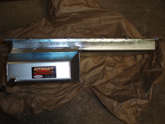

This is the pan I'm going to use, cost a little more but it's a quality pan that works. I'm not sure about the which mounts to use. But I saw some on ebay that they said works with stock subframes called Dirtydingo.

Thanks for the feedback.
I have now ordered the mast pan since my pan is clearly to low. Guess i was a litle to quick on the trigger when i ordered the GM one.
I looks like headers run aprox as low as the tranny crossmember so the total height of the motor is fine. Its just the oil pan thats a litle in the danger zone.
Thanks again.
