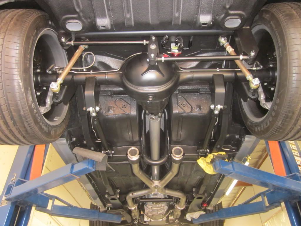

Originally Posted by Cris@JCG View Post
Where did you guys get that rear suspension set up from? Is it a custom job?
