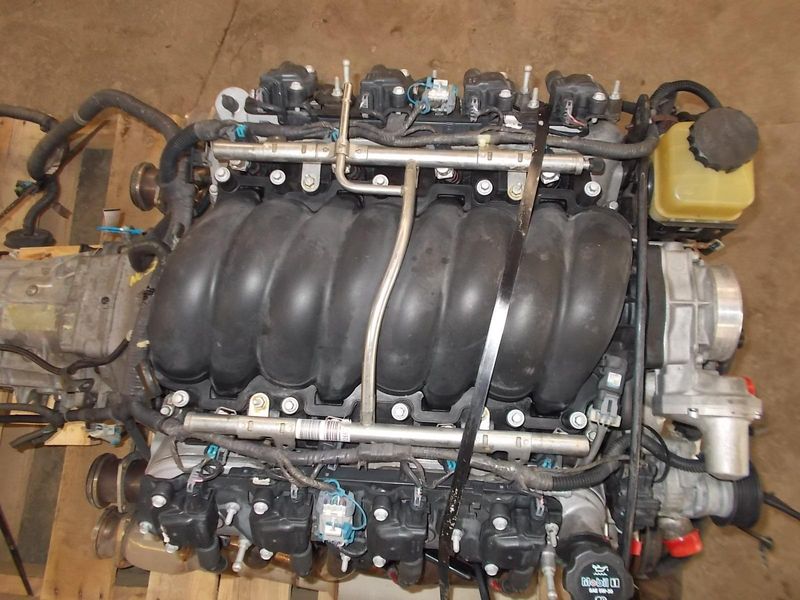

Yes, that is an LS6 intake.
What are your power goals? The LS1 is a great engine.
I want a platform that I can do enough work (cam, lifters, turbo) to eventually get a solid 550-600 on the ground. I'm planning on doing the turbo the same time i do the new front clip (winter of 2014). I'm planning on having this rig drivable by next summer (no turbo). I know a lot of people claim high numbers on horsepower, but i think i'm one that isn't 'all talk' (at least based on my jeep build i just finished dumping way too much money into...haha).

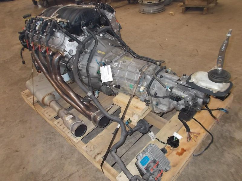

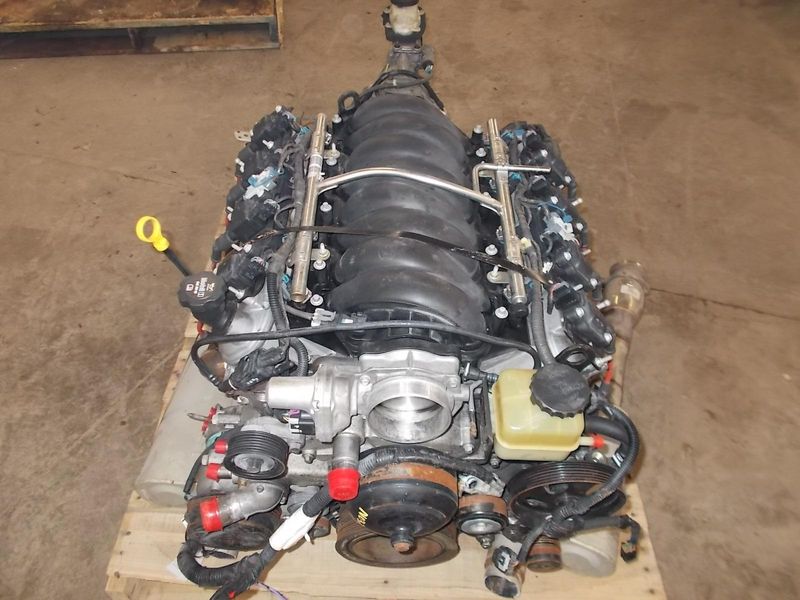

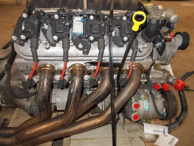

Well, just purchased the Engine and Transmission today. 2006 LS2 (out of a GTO) w/ 31k miles, Patriot Heads, LT headers paired up with a T-56 6 speed transmission.
Posting my LS1 for sale soon...

Nice drivetrain pics!

2006 GTO LS2/T56 running (before being pulled and shipped) Can't wait to get this thing bolted into my car!
