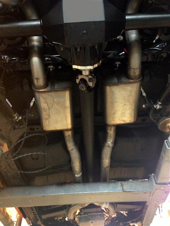

new moser M9 rearend installed
Setup
- M9HP1 Bolt-in Hsg & Axle Pkg
- Powder coat housing
- powder coat case
- Wilwood Pro Street Disc - WITH E-Brake
- Moser Performance Nodular Case
- Wavetrac 35 Spline Posi
- Alum. Daytona Support
- Setup Kit 28 Spline Pinion
- 1350 Pinion Yoke - Steel
- 3.00 gears

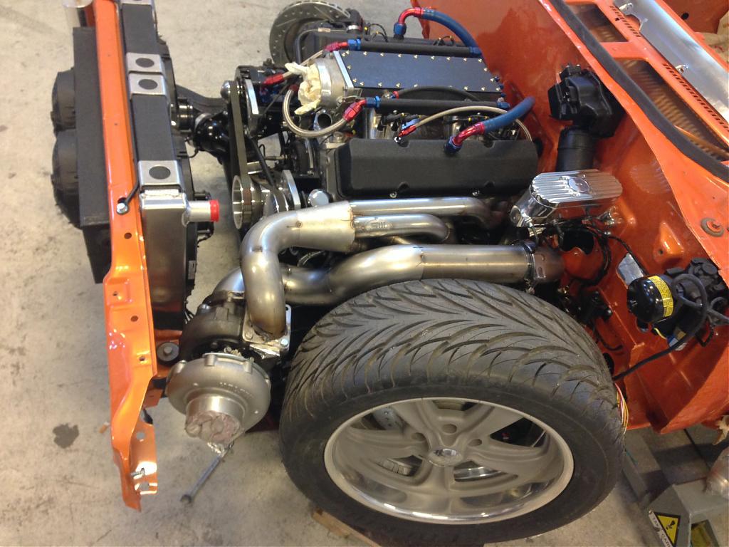

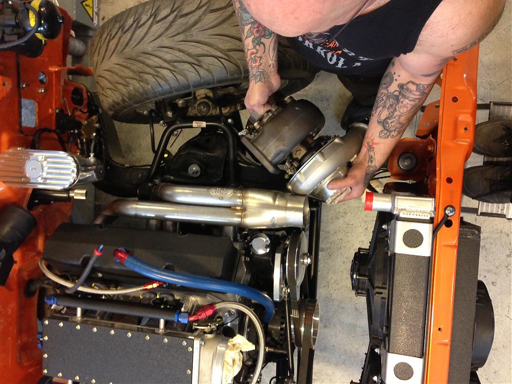

exthose system point welded and just trying to re-locating the turbos.. the stainless steel works SBC turboheaders had some falls , bolt pattern did not fit = did make new flanges to the heads. the primaries contact to valve covers and alternator and powersteering unit= we had to re-done the most of the headers.

re-locating the turbos.. the stainless steel works turboheaders had some falls , bolt pattern did not fit = new flange to the head bolts. the primaries contact to valve covers and alternator and powersteering unit= we had to re-done the most of the headers.
now we are working on the re-location. the drives side point weld on place.
