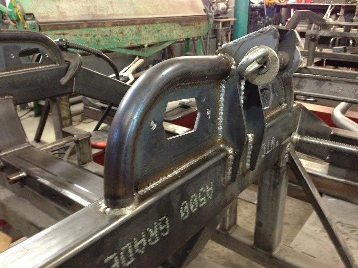

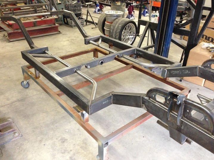

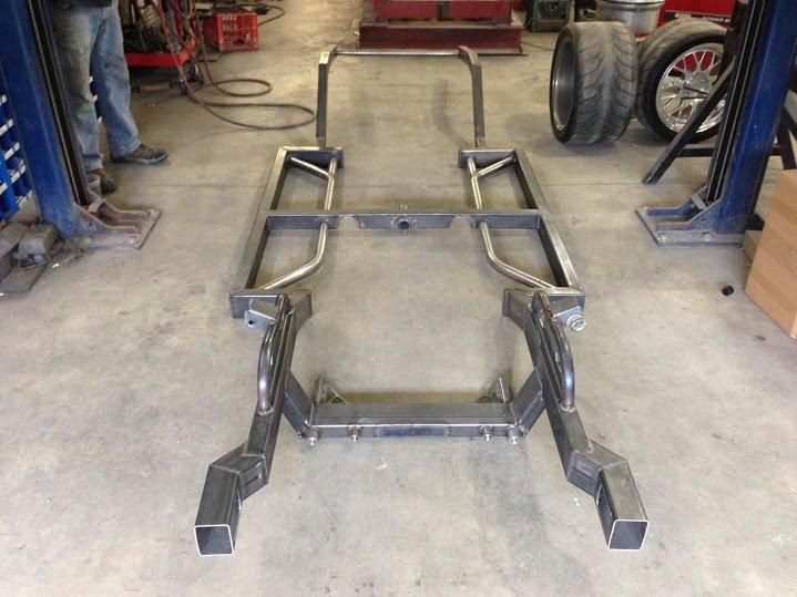

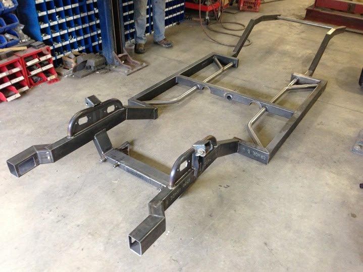

If you don't mind can I ask what size rect. tubing did you use for the the frame rails and the round supports?

I can tell just by looking at the tubing its 2x4 tubing, looks like Jake snuck a piece of 3x4 in there where the core support bolts on,and 2x3 for the trans crossmember. Don't know for sure, but looks like 1 3/4" round tubing on the center there. I'm running the same front clip on the AMX I'm building.
I really like the minimal nature of Jake's frame, keeps the weight down knowing that there will be alot of cage work holding it all together. Loving this build so far.

The 2x3 for the torque arm crossmember was done like that so when I run 3 inch exhaust it will not hang below the frame...Jake's idea

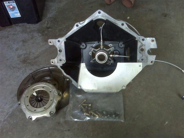

Magnesium Quarter Master bell housing, flywheel, Tilton tri-lite throw out bearing, Quarter Master 7.25 triple disc clutch and billet starter....$500 for all.
