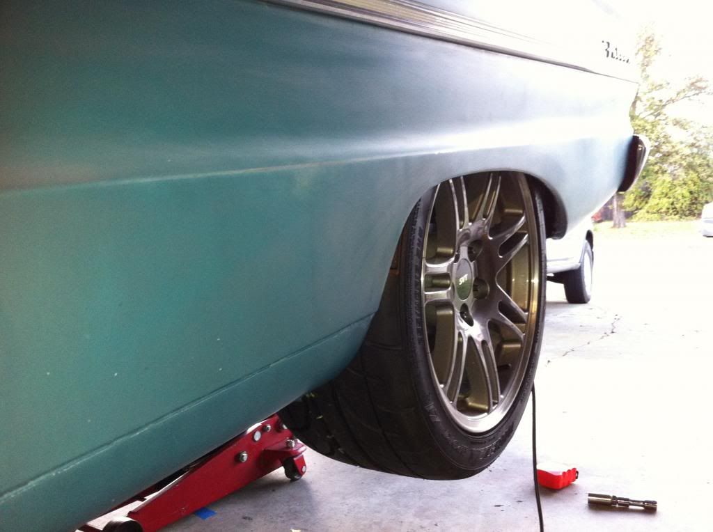

Getting closer. It is going to be sick. I think I got all my pickup points figured out for my drop spindles.

I finally got it back on the ground. Improvement in grip is phenomenal.
