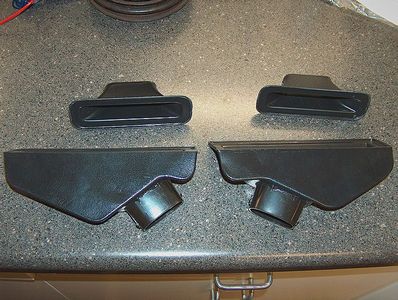

Here is a picture of the defrost vents. The univeral ones come with the kit and I assume that the bottom ones are part of the sure fit kit.

yeah the top ones are the universile and the bottom are the first gen vents, I have those and decided to use them. The drivers side worked better than the passenger side, for that one I had to make a bracket.
Tony

I am in the process of installing a surefit kit in my 68. Unfortunately the S&P brackets will not be here in time, so I wiil be doing the Power Tour without air. The VA defrost vents (designed for camaros) fit OK. Basically you have to fit them as close as you can and then mount them with a sheetmetal screw.
