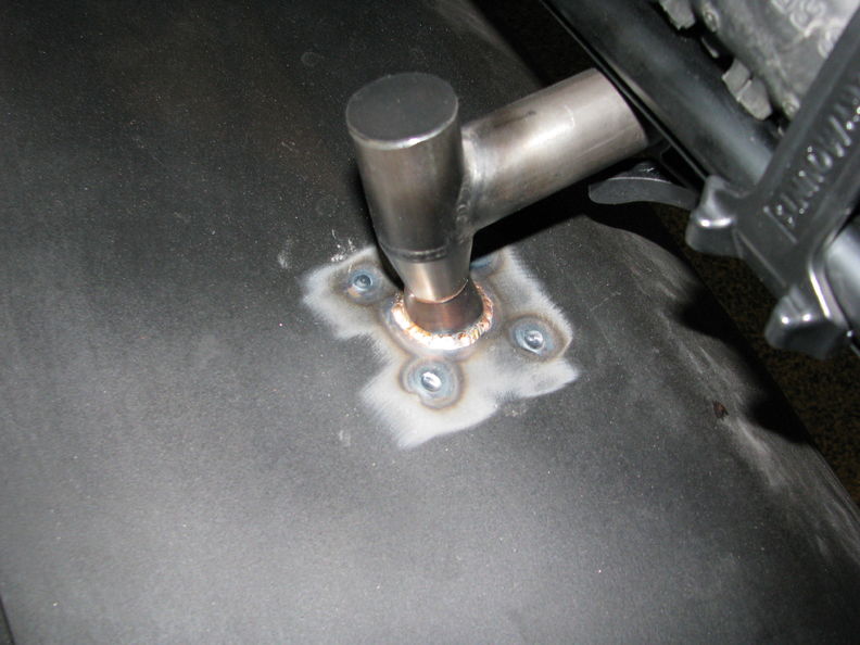

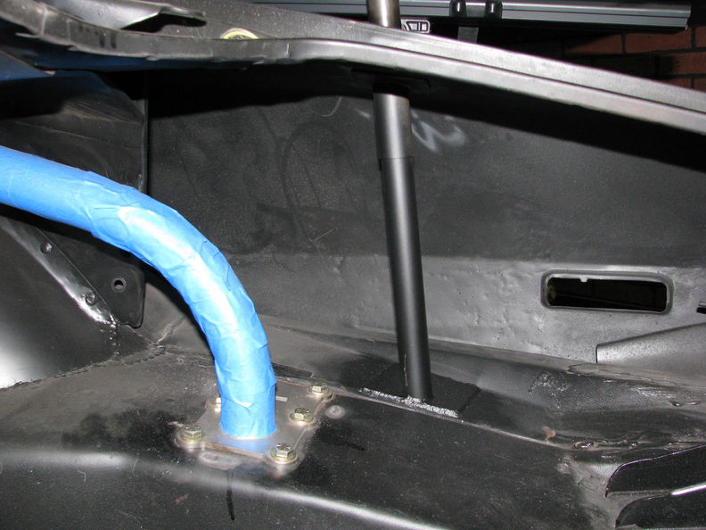

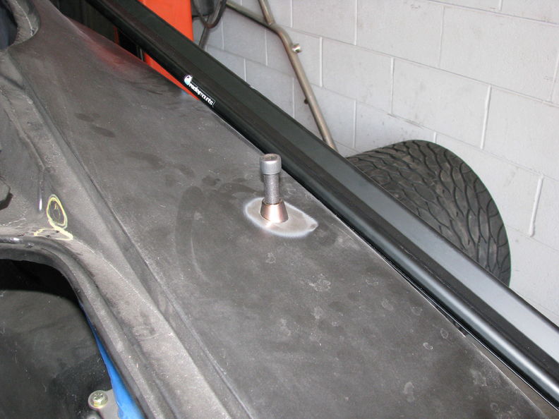

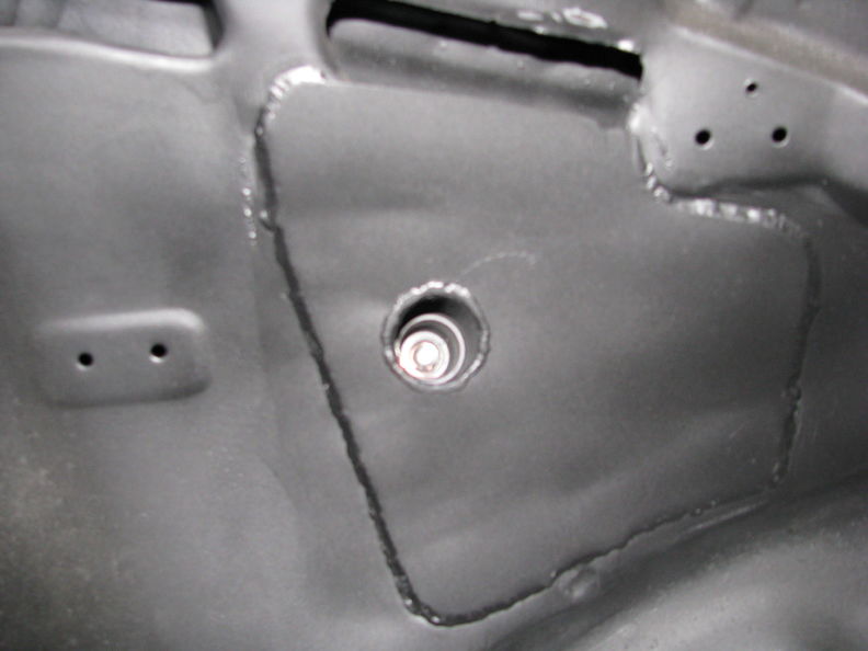

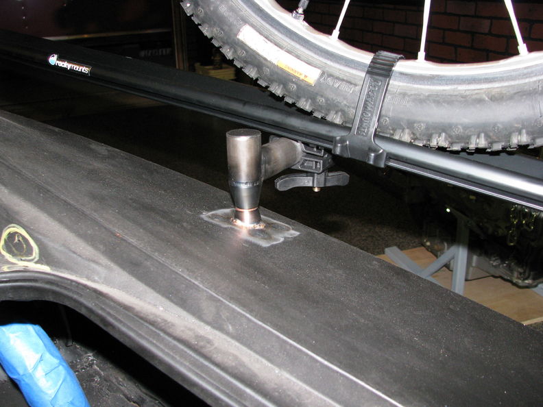

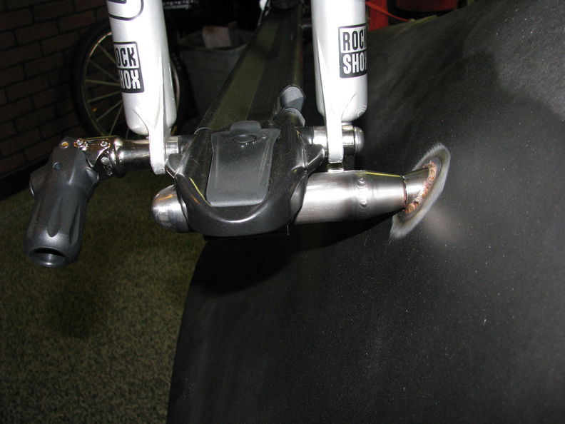

2nd Chance Camaro - High Speed Welding Bike Rack
2013 04-11 2nd Chance Camaro - High Speed Welding Bike Rack
www.2ndchancecamaro.com
Good Evening All,
Here is an inside look at the "B" Pillar.
Once all of the welding was complete Joe added a final plate to increase strength.
There was already a hole in the quarter panel from the antenna so we decided that the rear mount would use the existing hole.
The mount is then bolted to the bung which exits the quarter panel.
We used the existing brackets from Rockymounts to anchor the tray to our bracket.
Both mounts are removable and once removed all that is left is the bung.
