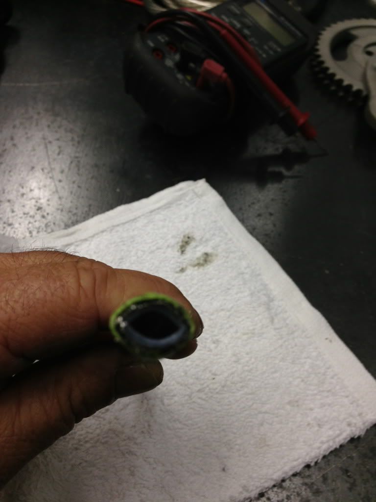

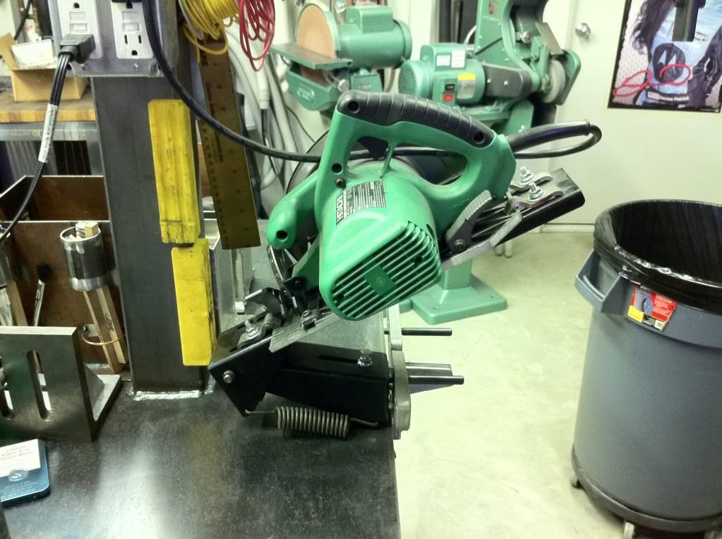

Do you plan to make up these lines on your own?? Have you done it before?? These are difficult to do -- I do them all the time -- but I have a special saw... and I have the insert tool etc.
It's not rocket science but it is a "process" that is more difficult than other types of hose/hose ends.
Aeromotive has PTFE hoses and ends as do several other manufacturers. You can also usually find these hoses and ends (although they call them JIC rather than AN) at hydraulic hose shops...
Remember to index the ends... as these don't swivel!

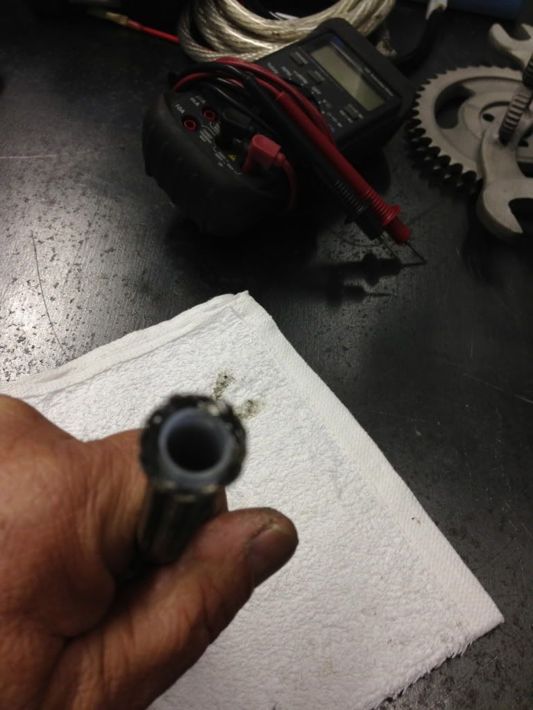

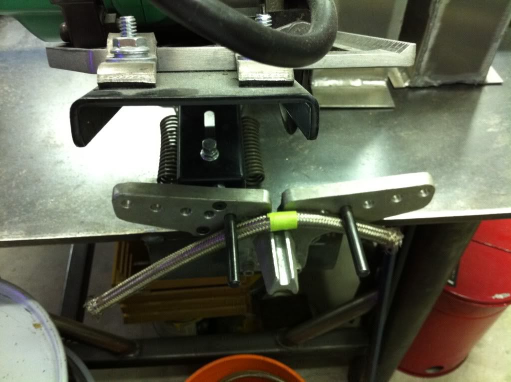

When I said I have tools for these kinds of lines ----- I have a saw that has a blade that resembles a meat slicer... it cuts the SS braided cover and slices thru the liner without deforming it or melting it etc... it makes a perfectly nice squarely sliced "end" of the hose....
Then I have a tool that takes the olive and inserts it (the olive goes between the braid and the PTFE liner). You first put this tool in the hose end - which slightly expands the braid -- and also smoothes out and slightly (as in extremely slightly) opens the end of the PTFE... then you load the olive on it and push the ferrel onto the end of the hose.
These are not complicated tools...
