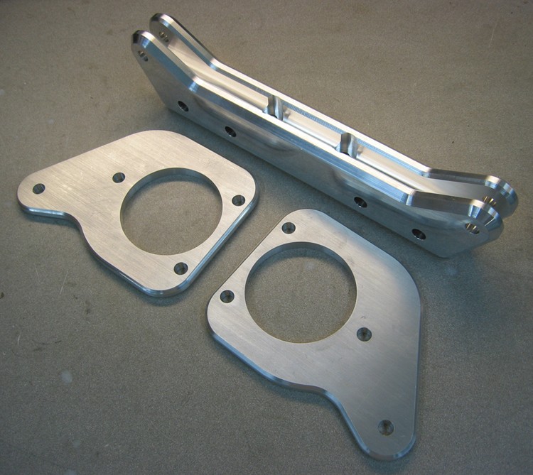

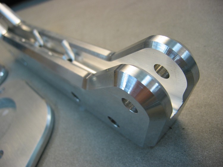

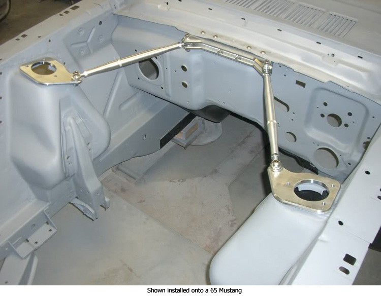

I guess I am finally getting into the spirit of getting the car, finally back on the road again.
I wired in the new signal indicator, and confirmed the coilover order yesterday.
After reading the instructions this morning, the assembly is integrated with the export brace. This means it's a little more work to re&re the engine with the coilover system.
But after a little thought I decide to get the billet shock tower brace. That way I can mount the coilovers permanently and just remove the braces, for popping the engine in and out.
It's a pretty nice piece and the right decision, I think.
Shaun's cowl bracket is one of the nicer pieces out there.

I think you'll like the kit. Im using the Total Control Products front suspension on mine and think it handles great. (Virtually the same thing) I did however go to a Fatman dropped spindle to get my ride height. I currently run a 265/35-18 and have plans to change to 275 soon enough. There is enough room under there, you just have to NAIL the backspacing.
The export brace setup is awesome. I almost purchased it for my mav but there were too many differences between the Mustang and Mav firewalls to make it work. I might go back and purchase the shock tower plate and rods later if he'll break up a kit though.
