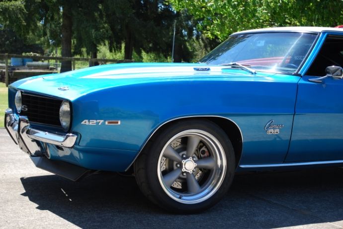

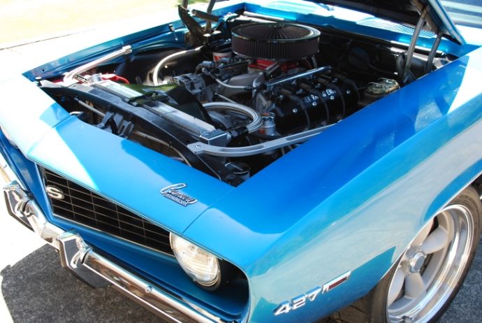

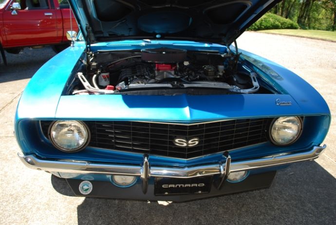

This past weekend the weather cleared up, and the sun was out so I took a few pictures.
Nice to have the car done... and back on the road again after working on it all winter

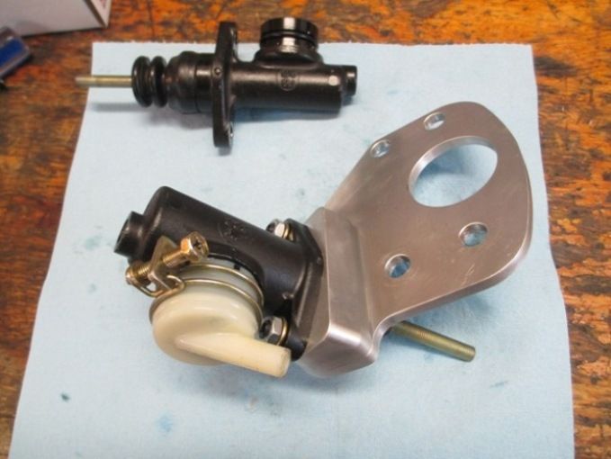

The only issue I had on the transmission conversion was with the hydraulic clutch kit. The kit came with a Tilton ¾” bore master cylinder with a 1.1”stroke. I ended up using all of the stroke to get the clutch to disengage. I drove the car for about a week with this set up… but didn’t like the feel of the ¾” bore master… it took too much travel on the pedal to disengage the clutch… and it was difficult to shift quickly. Maybe the GM twin disc clutch just takes more travel to disengage than a single disc clutch. I ended up replacing the ¾” bore master cylinder with a Tilton 7/8”bore and now it’s much better. The action is quicker and the clutch feels just right.
Here is pic of the 3/4" bore master cylinder on the bottom, and the new 7/8" master on the top
Ready to go back in the car
