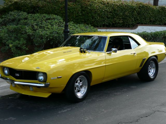

I bought the car from the US about 4 years ago. Long story short bad buy.'
It looked good in the pictures, but we all know how they can lie.
As it was when I bought it.

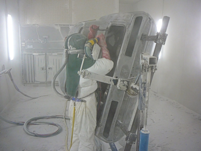

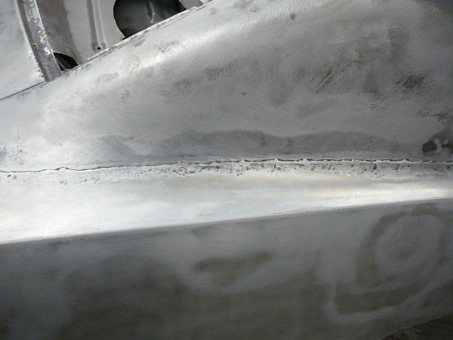

I own blasting company, so we stripped it and look what we found.

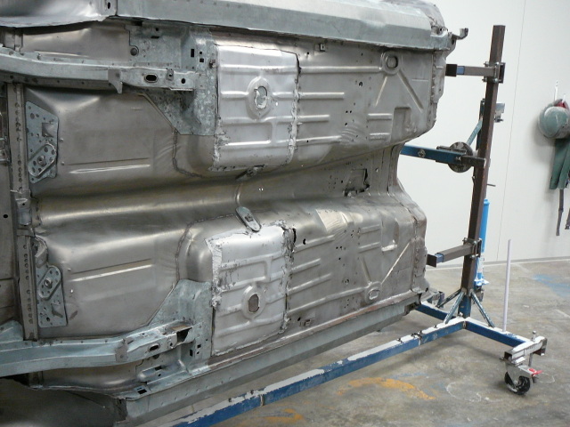

We replaced both quarters, full floor,trunk floor, firewall,roof and both outer wheel wells. I sold of most of the car as I decided to go with a Pro touring setup.

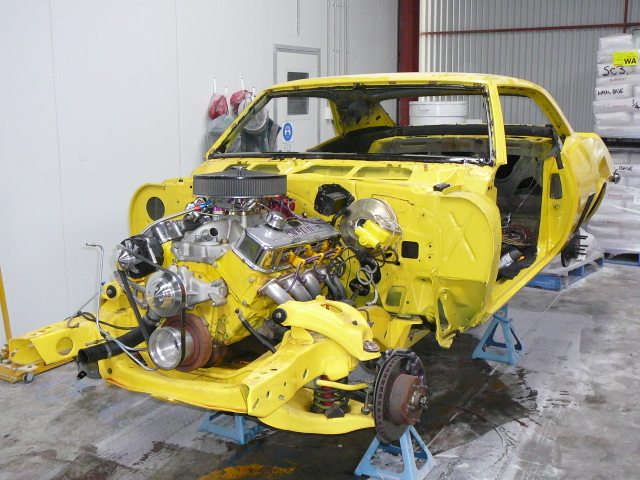

I have set a mock up engine in place, I am running a tall deck RHS block, but I don't have it here yet, so I needed to simulate it by raising the heads of the one I have.
