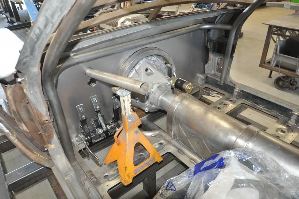

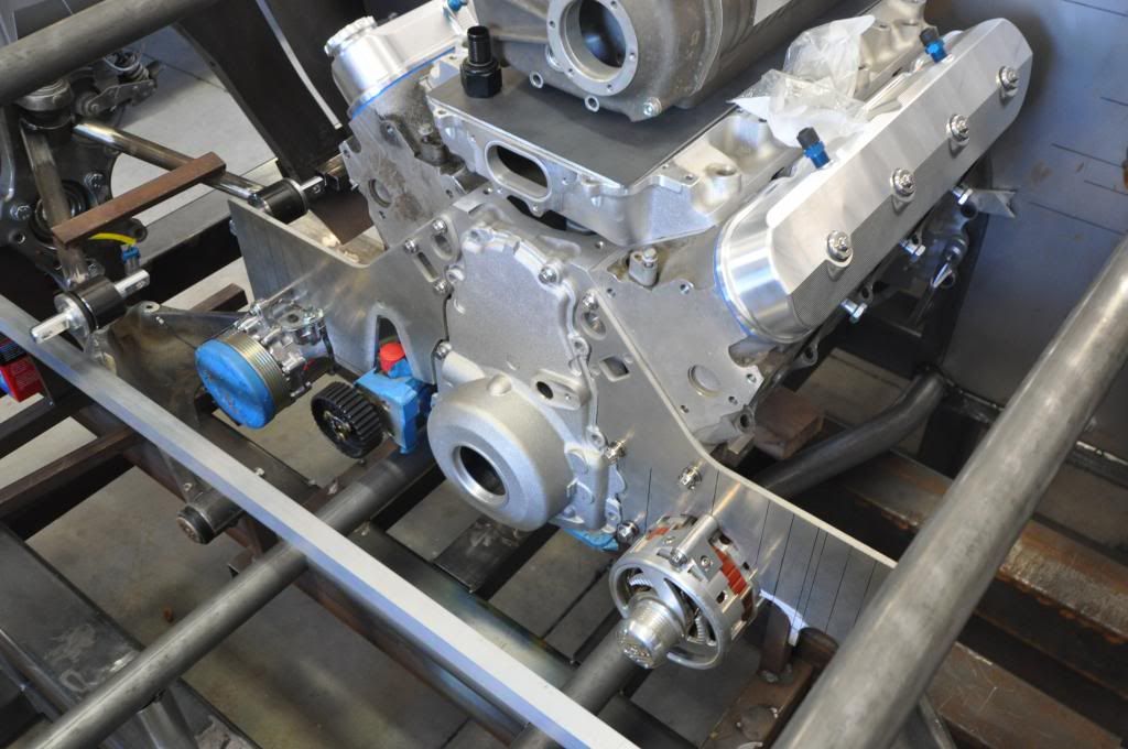

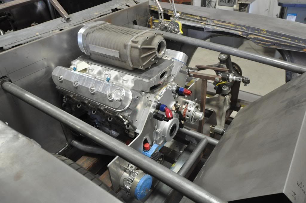

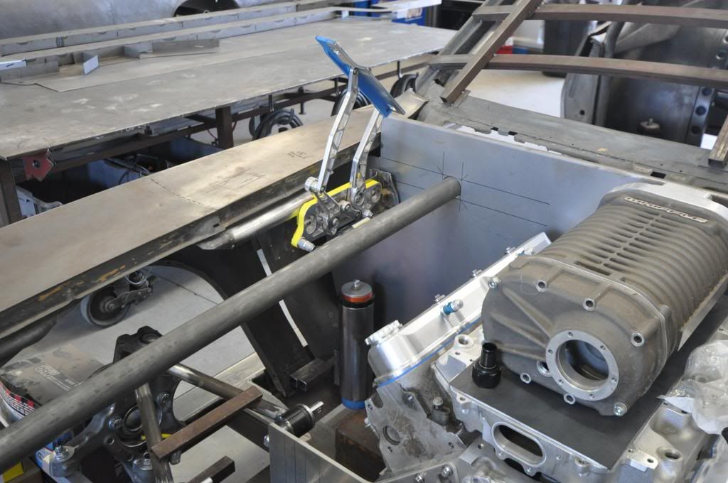

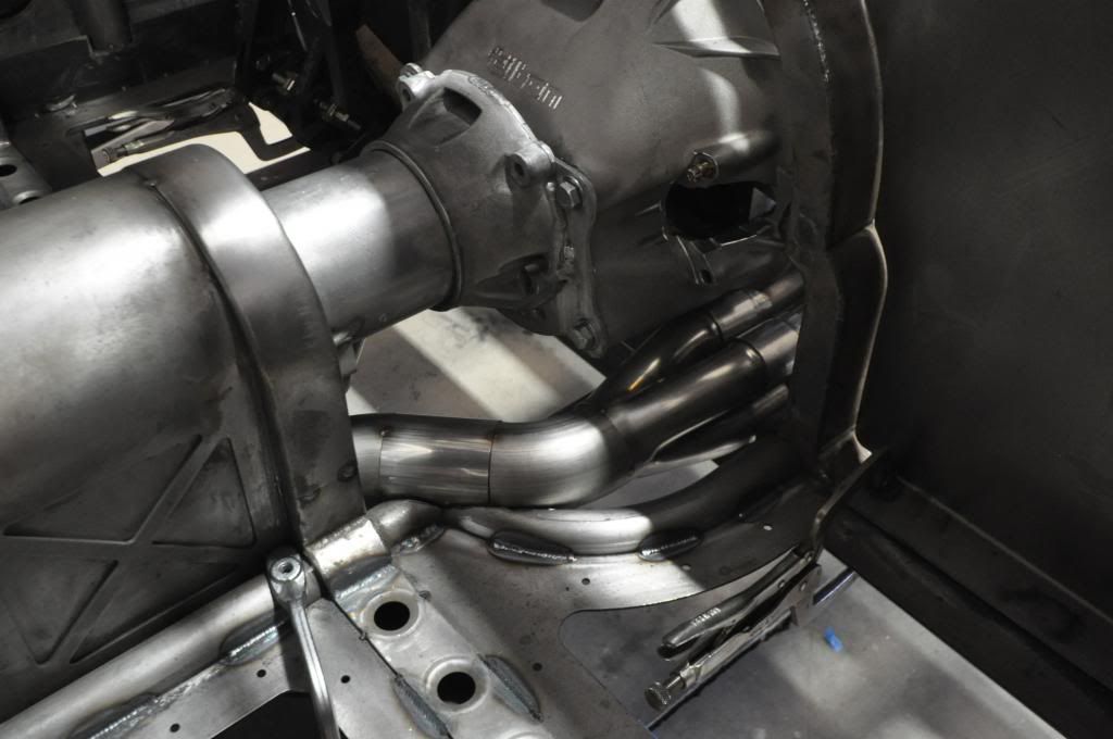

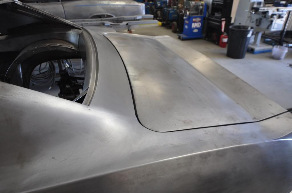

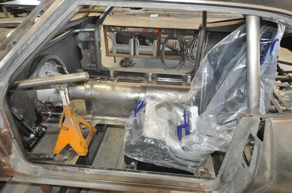

Well I guess it's about time for an Update on the widebody Camaro project.
Things have come long pretty good in the engine compartment. We are working to get the front suspension crossmember designed and getting the Alternator and AC compress in a low key position. We mocked up a rough seat in the car and are working to get the steering column position set up. We all closed up the panel below the rear window where the car was shortened for less over hang.
We are just mocking up some hinges to see how they will work in a rear ward position nearly 6 inches back from stock with the new firewall position.
This steering column position will be critical for comfort behind the wheel and header clearance and having the column high enough at the firewall to give plenty of room for the movement of the pedal assembly. You can also see the bellhousing mounted starter in position on the passenger side.
Enjoy the progress

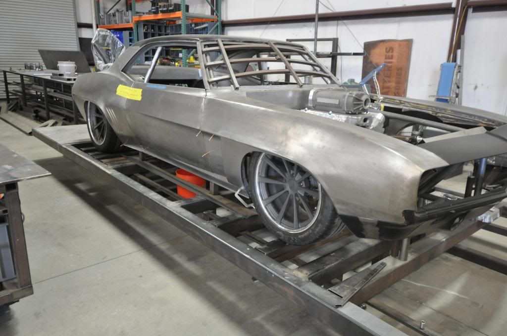

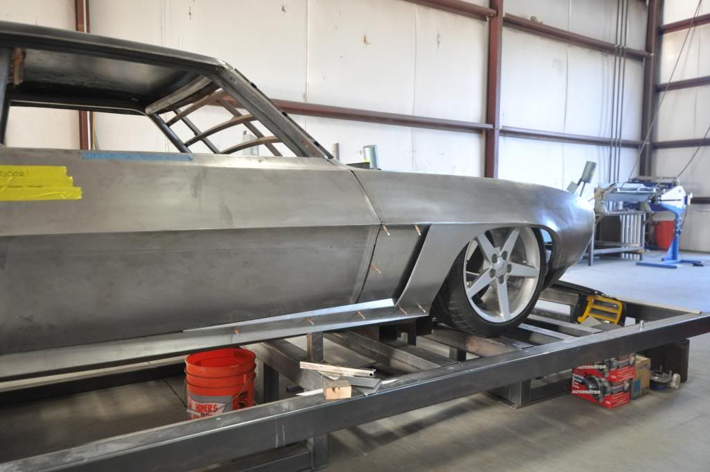

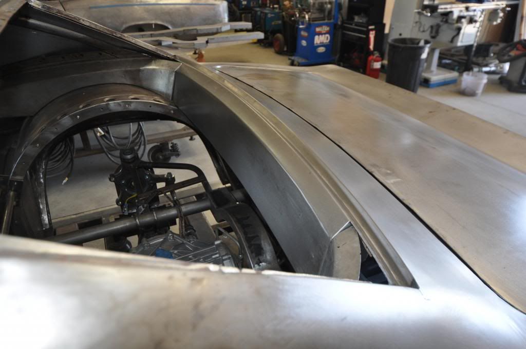

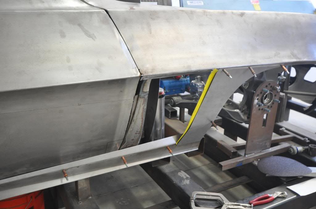

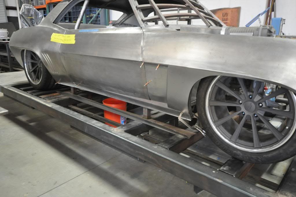

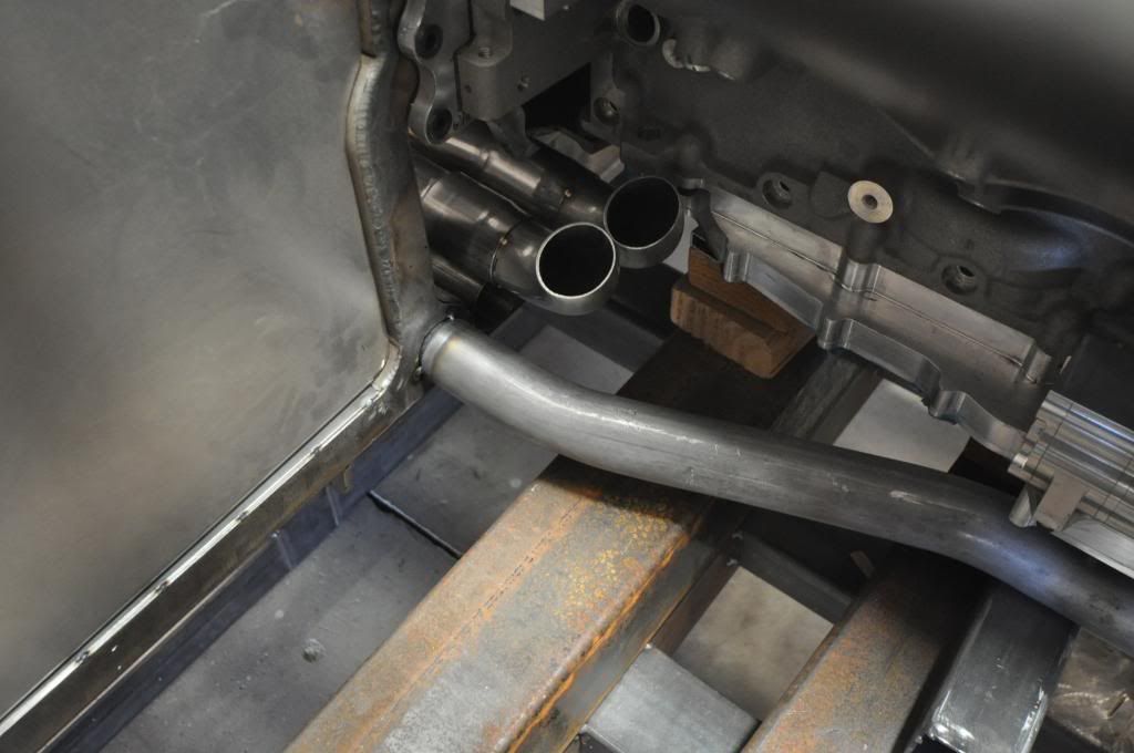

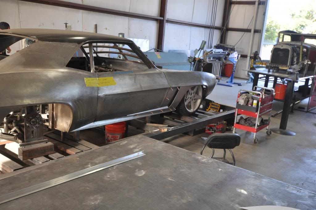

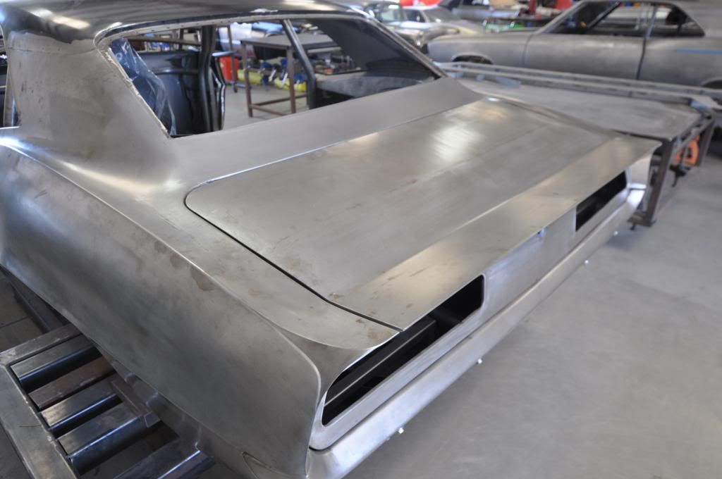

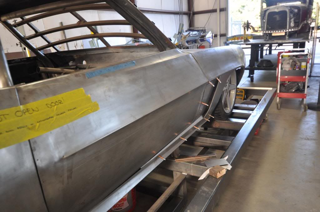

I was just getting ready to do an update on a few of our projects in the works.
We have been working on the lay out for the side vent on the front fenders and I think we are getting pretty close. The Customer thought it was mostly perfect.
We are going to make a few changes to the floor lay out due to the new lower engine position. These headers are going to be tough but we should make they work and still be removable.
We are working with the relocated water pump idea and mocking up a slanted radiator.
Rough overall pics of the side profile.
