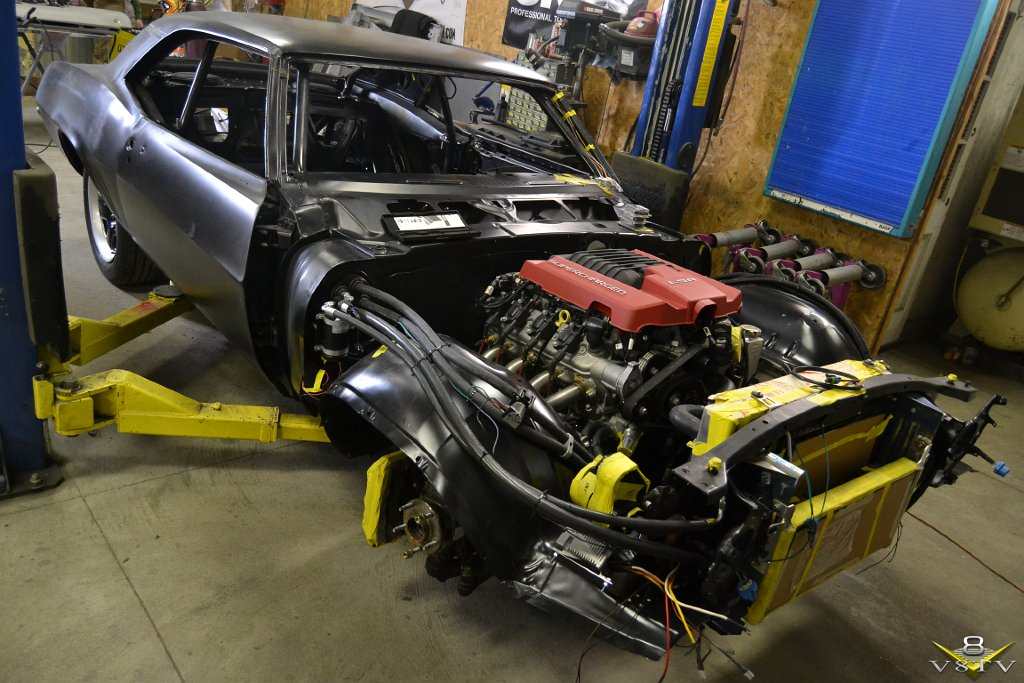

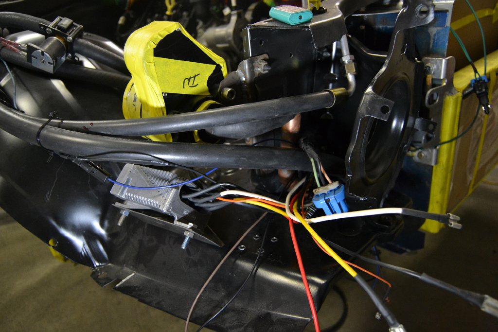

This picture shows where we decided to mount the Corvette PWM modules.
Only one module shown in these pictures.
A second module will be mounted on the outboard side of the same bracket.
The stray wires are prepared and ready to be plugged into the second module.
