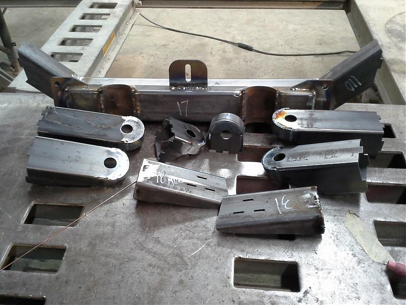

I started welding. I choose the front radiator support first. The pieces fit like a puzzle. I don't know how long Russell had to program all the cuts, but it is worth it!

Thanks Russell, you can explain it better then I can. I was able to get more welding done. I did all the body mounts and cross members. Once you are in the TIG zone it is hard to get out of it. LOL Time just flies by.

I am surprised I haven't had comments about my welding. As you can tell by the burn patterns, I am using the MIG on certain area's. The majority is TIG. By the time the frame is finished I might be pretty good! Here are the start of the outside frame rails.
