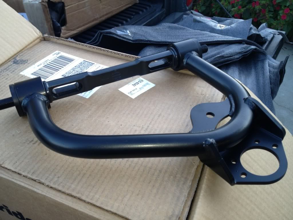

I received the revised 1st gen F-body arms yesterday. They look great. They only come with the zero offset slugs, so I'll have to order up some of the offset slugs to get the caster where I need it. Other than that they seem to be a very high quality piece. I just got off the phone with Ridetech and they are sending me the offset caster slugs. That is excellent customer service and product support. Light years ahead of my previous suspension supplier.
