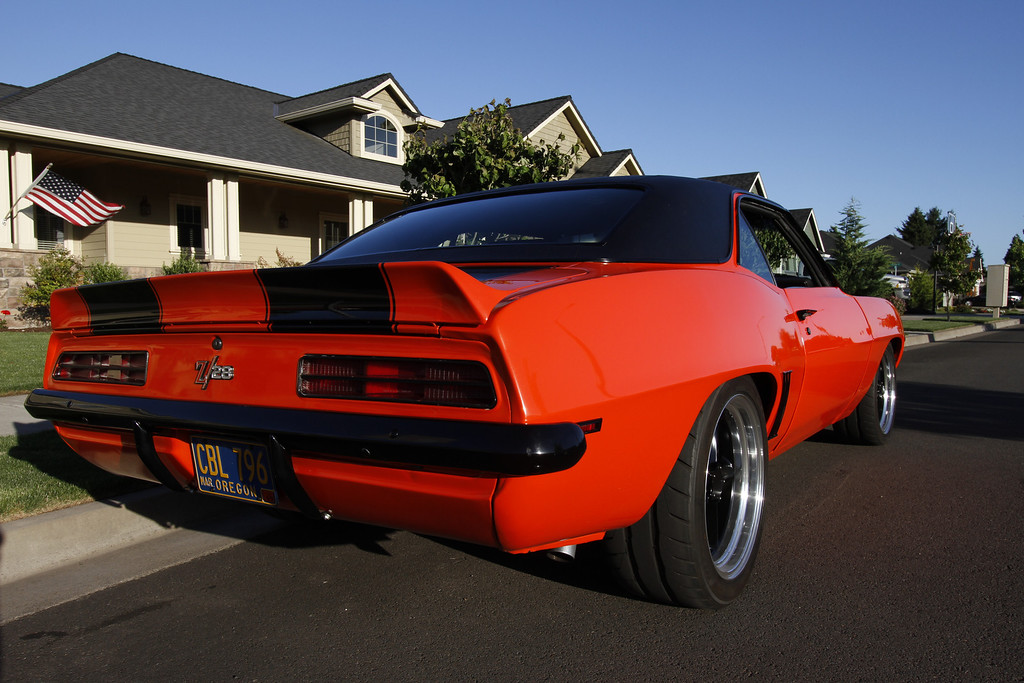

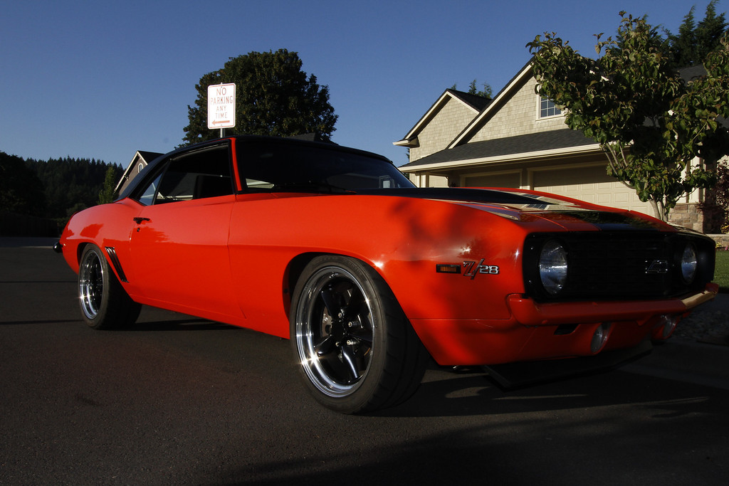

Did a little clean up after the two short road trips, which led to getting the buffer out and hitting the topside with some fine cut cleaner.
The Ol' boy ain't lookin' too bad for 24+ year old occasional driver paint!

She looks good How was driving it after all the changes?? I take it this was the longest trip so far??

that looks just right. Great stance, i love the black rims, orange paint...i've said this before , blah blah blah.
But with that said, still one of the best lookin cars on the planet, the 69 has to be in my top 5 fave's of all time, and yours is set up just right imo,...

Thanks Gentlemen. It's times like this that make hanging on to it for 24+ years worth it all.
