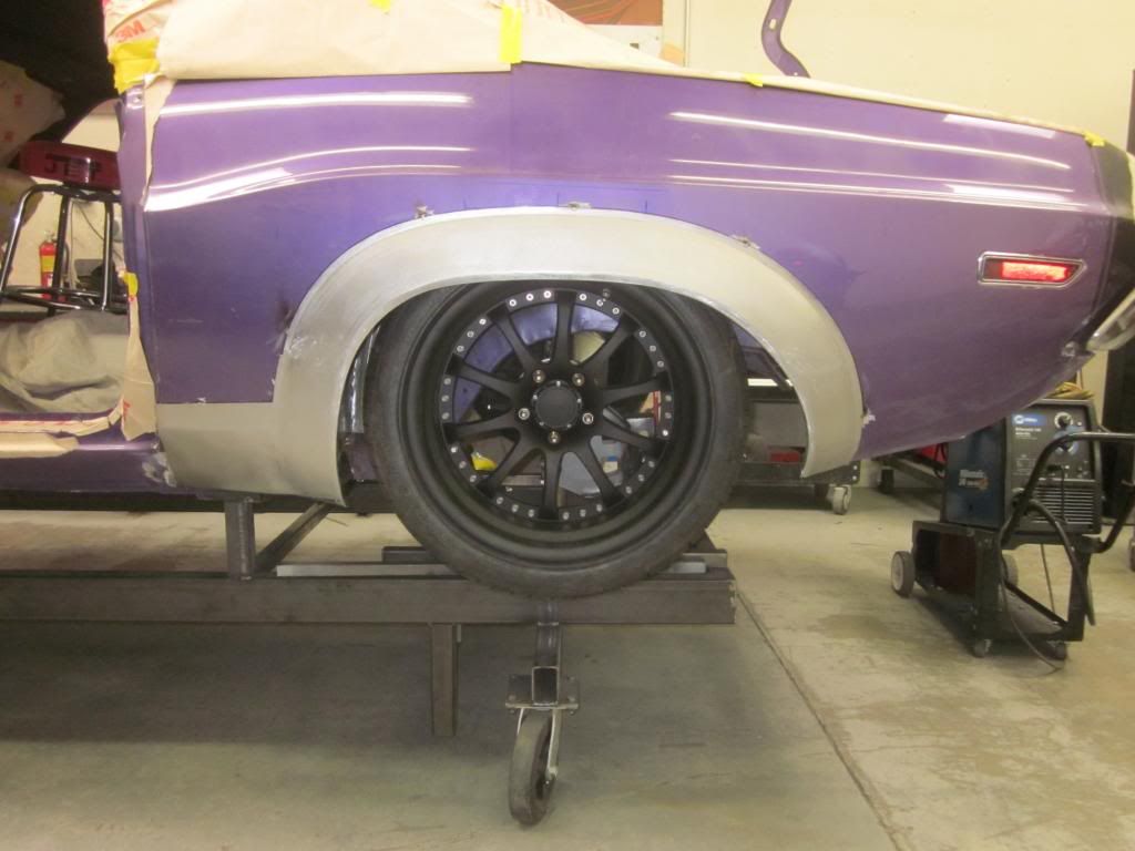

Got some rear stretch & flares going on today in the fabrication shop… We lowered the top of the opening to give the car a lowered effect to maintain ground clearance & suspension travel.. But we also pulled the lower bottom of the qtr so that we keep from kicking up rocks to cover the tire but also works as a deflector of air ..

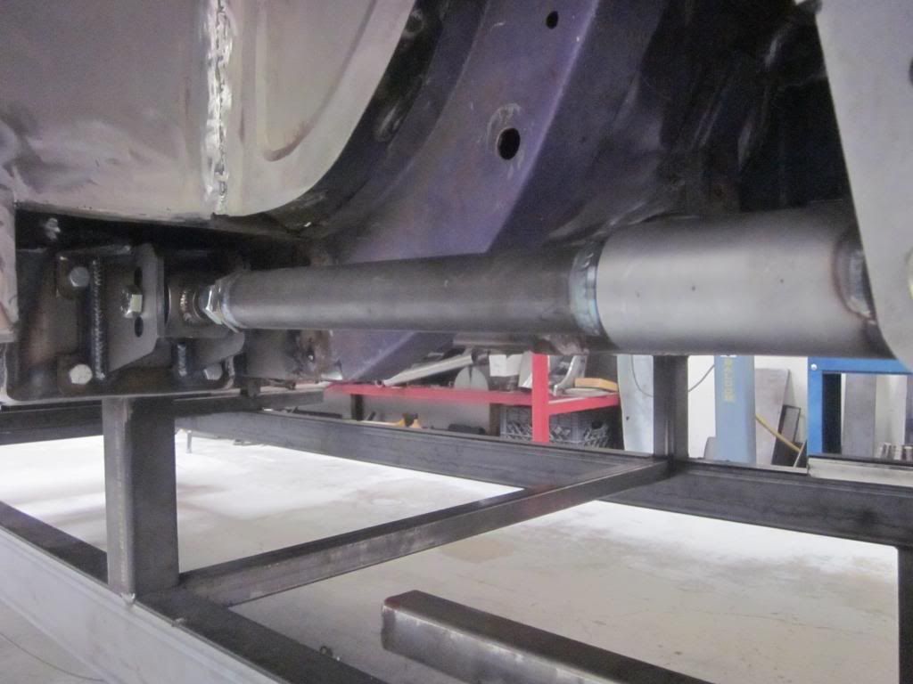

In the last 6 months I have developed a working relationship with Borla Exhaust! This is something custom they do for JCG on the exhaust tubing & custom mufflers… What you see is 2.50 & 3.00 tubing .049 wall.. Next tubing kit they do for me will be 2.75..

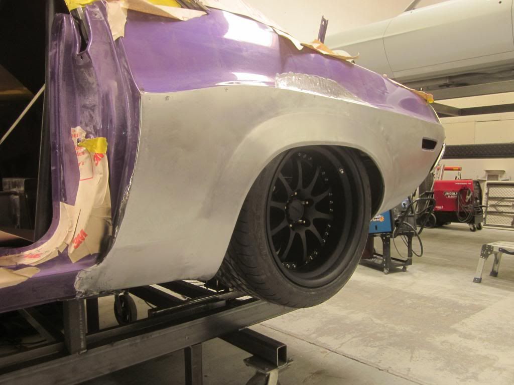

Got all of the driver side qtr panel done with inner well complete yesterday! I am really looking forward to seeing this car on the ground...

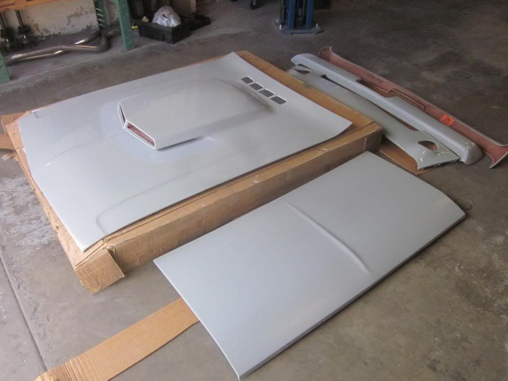

Just got all of our fiberglass pcs from AAR..

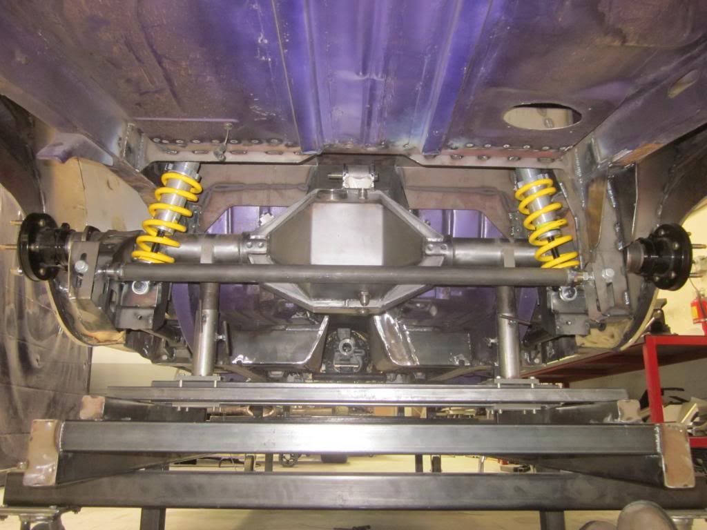

WE got some suspension in the Challenger this week… Next week we cut it off the jig..
