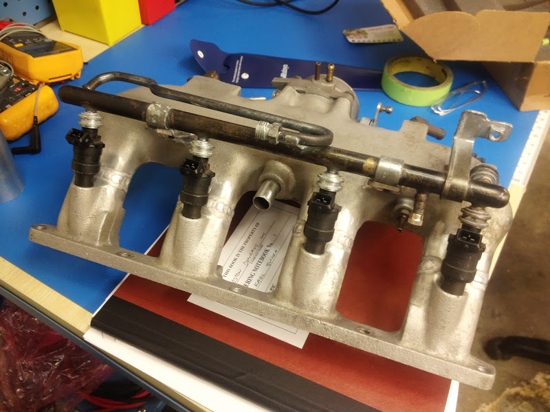

During that time we also decided we wanted a simpler project that could actually be driven before this century is over, so that took up most of the latter half of 2013. It's still a Volvo 240 (big surprise, right?), but more quick and dirty than anything else.
'83 242DL. Two doors, skinny bumpers, 5-panel tailights, no sunroof, and the older style front end sheetmetal make this the best 240 to have. This is a roller we've had sitting around for a while that finally got an engine.
The longblock is pretty straight forward. It's basically a freshened up DOHC "redblock" out of a 1990 740GLE with h-beam rods and upgraded valve springs.
Shortened intake manifold, 800cc injectors, 3" throttle body from a Volvo 960.

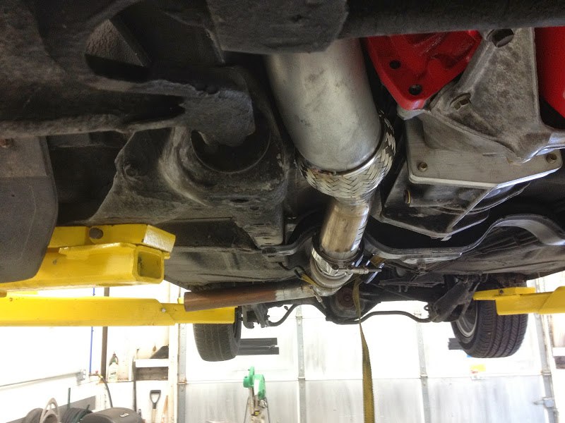

3" aluminum charge pipes with a home made blow off valve built from repurposed single barrel Stromberg float bowl covers.
4" downpipe to a 3" side exit.

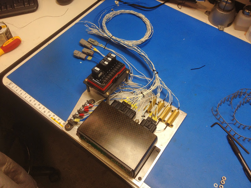

A VEMS ECU does the engine management.
