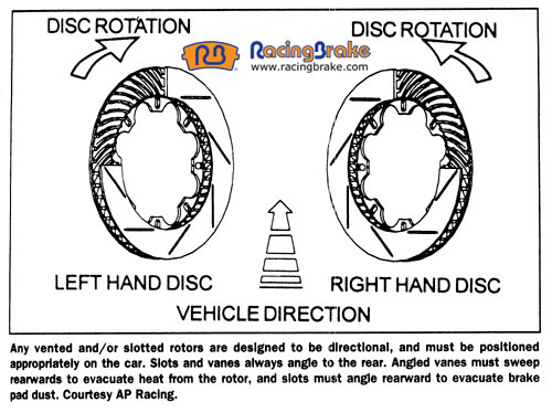

Slotted/Grooved: The grooves in the rotor … often called slots … help "clean" the debris from the brake pad. That’s it. It’s a good thing. The grooves/slots need to run a specific direction. See the illustration below.

Vanes: Are the most important cooling feature of the rotor itself. The vanes of the rotor … spinning on the hub axis … create a vortex, sucking air into & through the rotor’s vanes … helping to cool the rotor. These are simply referred to as vaned rotors & they come in a lot of configurations. The details matter here. The air travels from inside the rotor to the outside, not the other way around as is commonly thought. So the vanes must face rearward when viewed from the outer diameter of the rotor.
Straight vanes do not work as well as curved vanes. There are made & sold as an economy product, because they can go on either side & store doesn’t need to stock left & ride side rotors.
Curved vanes
are the way to go. Just think of fan blade design. The vanes scoop the air from inside the rotor … suck it through the inside of the rotor … cooling both sides … and out the top.
