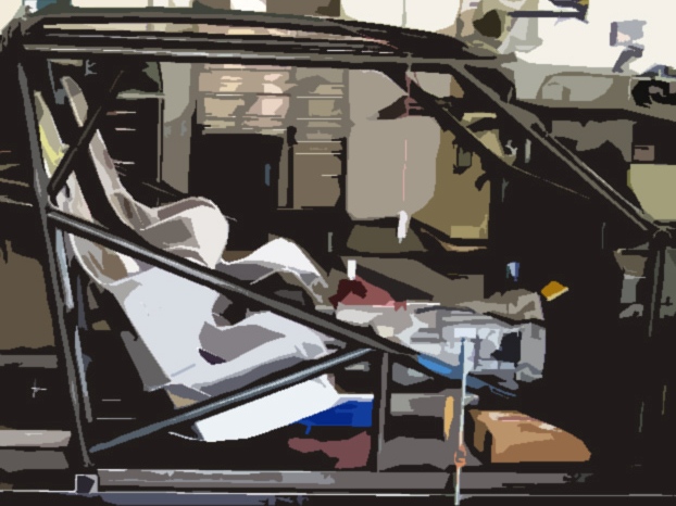

We are going to be making an Exact-Fit cage for the second gen Camaro. If you're in NorCal and looking to have someone install a cage in your car, you might check out THIS LINK then give me a call. Exact-Fit cages are available in 1-5/8" ERW and 4130, or 1-3/4" ERW or DOM. Roll bars are available in 1-3/4" ERW.
It will fit like the image below, only in a different body. Currently, we are working on the 67-68 Mustang version. Whatever car shows up next that wants one is what we will build.

  #23

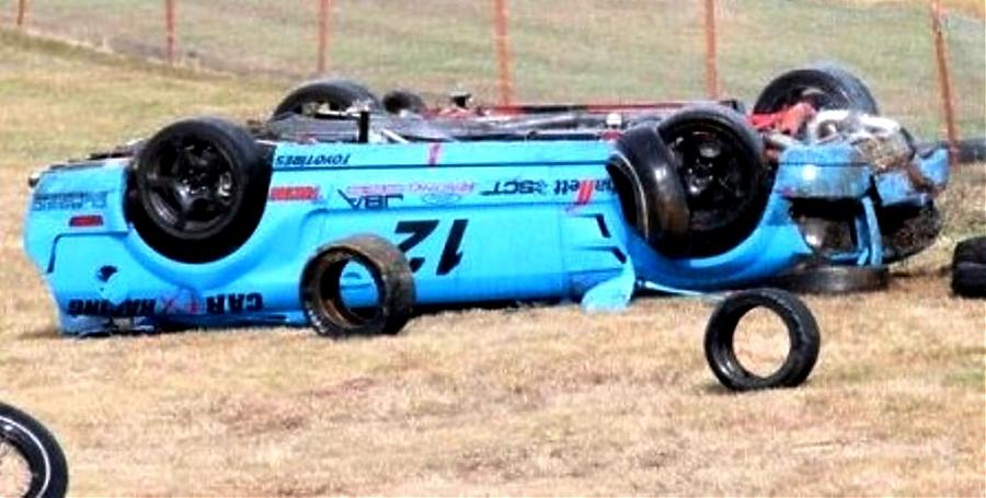

Guys ... look at the blue mustang below & see where the roll bar pushed through the sheetmetal floor ... and the roof & roll bar crushed. I'm starting to like you guys & don't want this happening to you. The added chassis rigidity would pay performance dividends too, making the car more responsive to tuning changes, react quicker, & utilize the car's power & speed better.
Carl, I can not say with any certainty that PT guys would buy a stronger roll bar made out of 1-3/4" x .095" 4130 Chromoly ... but I know that is what I would sell & recommend.
