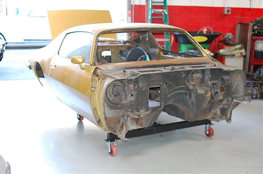

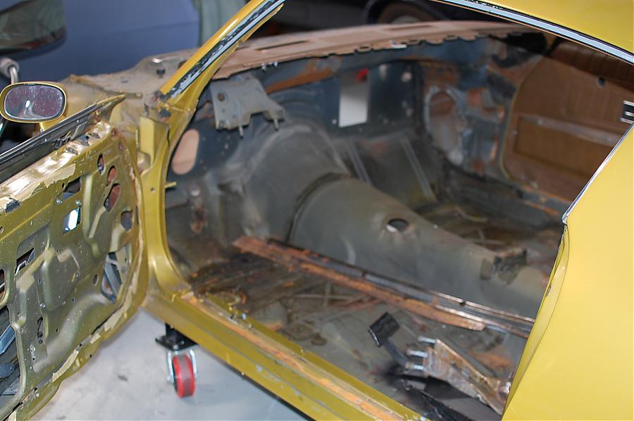

the body is getting stripped down and its almost ready to go to media blasting.

We are just doing the firewall, undercarrige, trunk and interior floor. There doesn't seem to be any rust on the body so i'll get to enjoy watching Greg DA that old paint off. Should be good to go. It looks like a respray but its hard to tell. No edges in the jams.
Doors will never be removed.
My media guy is the best in the business and knows how to clean metal. Never had an issue with Meyer's media in Oakland CA. Been using him since 87.

I was trying to get the body to the media blasters before I went on vacation but I had a few drop ins that had to get done.
The body is almost ready to go. I will cut out a few panels so he can get in all the nooks and crannies.
