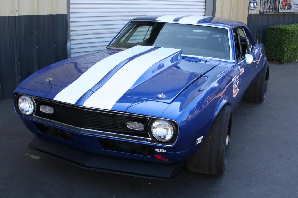

Ok.... wheels are finally done and on the car. I give you the Jongbloed Racing 330 wheel.... done locally in Morgan Hill.
18x12 front and 18x13 rear on 315 and 335 Hoosier A6's.

And the car is one the ground off the lift for the first time in probably 6 months. That's always a step forward.

And I thought the front of my car had stupid amounts of camber when I was looking at it the other day. BMF looks nothing but serious business now. And those wheels... I kind of really want some now.
Well this is only 2.5* actually, which is what Jake specs for my setup. I don't consider that too extreme. But maybe that's part of my problem... since I don't consider this car too extreme.
Matt Are you sure you can accept that hellafflush 315 on a 12" wheel up front.
