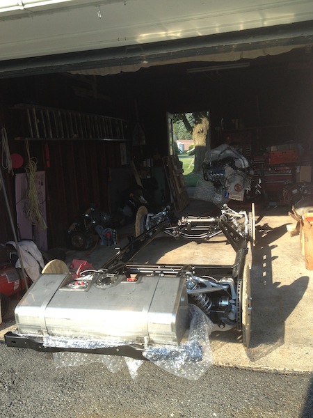

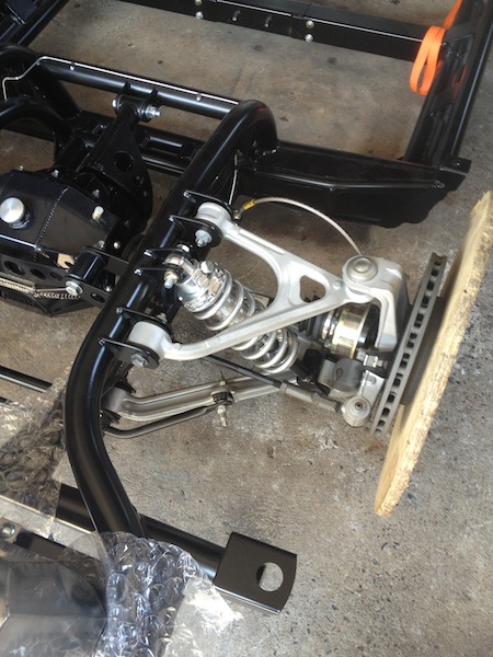

SRIII frame and c6 corvette suspension, Custom gas tank, removable crossmember

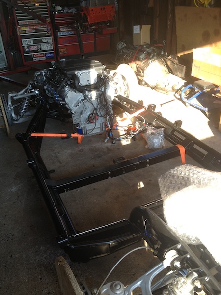

Ls9 on engine hoist in background

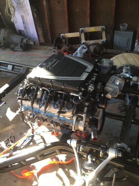

Ls9 added to SRIII frame

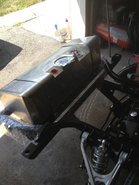

Custom gas tank
