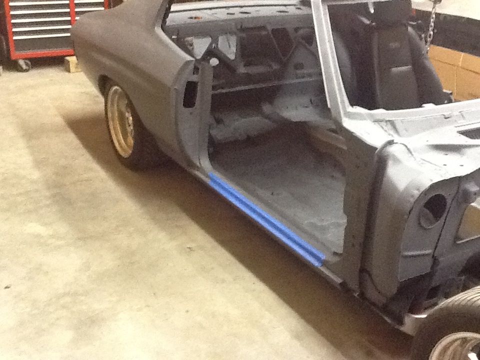

And another...
Thanks Dad!!

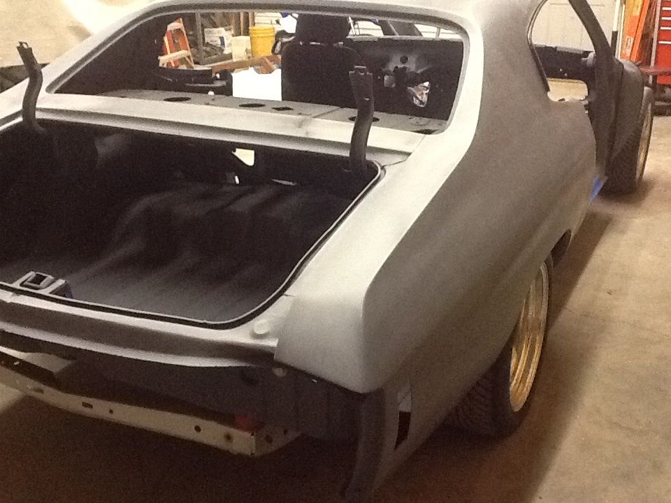

Rear view...
Thanks Dad!!

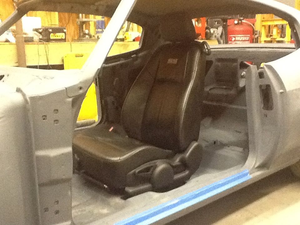

A picture of my seats that I just picked up from a really nice guy over in the PT classifieds. They came out of a Cobalt SS, and are in excellent condish.
Sorry about the fuzzy ipad pics.

Looks great, Scott! Congrats on getting the body back on. Are the Cobalt SS seats Recaros? I thought they were. They look good in there regardless.
Trey, I'm not sure exactly who makes these seats. They do not say Recaro on them anywhere, but they look great, and fit me perfect. Thanks for the compliments. Oh yeah, saw a Bugatti Veyron at AMP, and thought of you. You'd LOVE this place!
