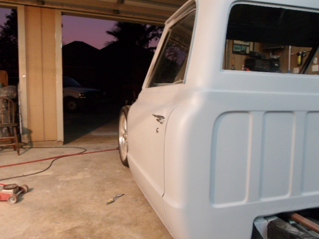

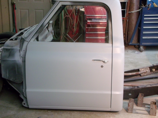

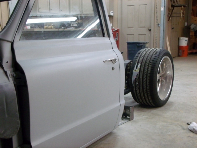

Was a real pain but in the end I like it.....As u can see these are RB"S 1st gen Camaro handles ......had to cut up 2 new 69 panels to get the geometry right....and do to the extreme angles from buttons to bear claw release i chose to use handles to electrically open door....started with early 70's repop alarm sws which are identical on outside to the stock lock cylinders...batt to them then to h.d. limit sw...push button..batt to h.d. door popper....pulls bear claw
Turn key sw 90*...no batt...effectively locked from outside...inside car..will have a mechanical door handle to release...and a cutoff sw for outside battery mounted in console....Sounds technical...but really simple and effective......jim

And yes handle was moved 1 1/4" down....also totally clears one-piece windows.....jim
