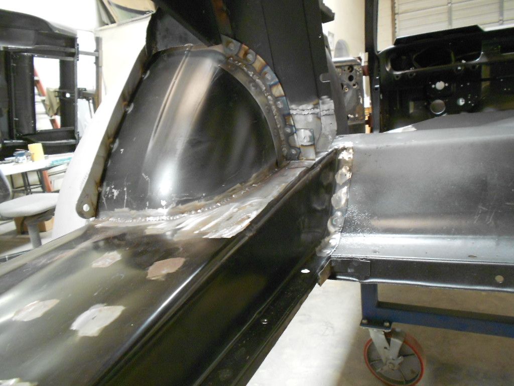

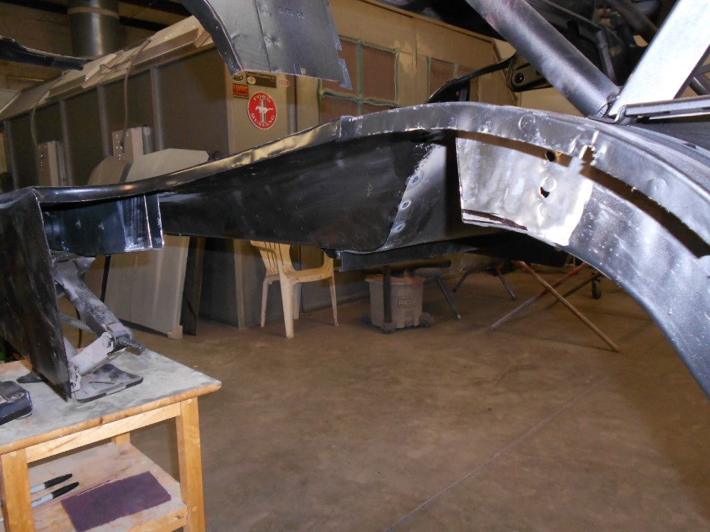

Brian wanted to fit the mini tubs before installing the quarter panels the first thing he did was cut out the frame rail to make room for the new one that come in the kit.
These braces come with the kit
This is what needs to be cut out for the new mini tub. You can go in 2" or 3" we chose 2" because in you go 3" you have to narrow the supplied frame rail 1"

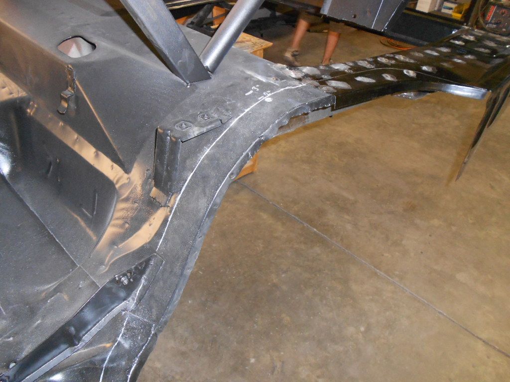

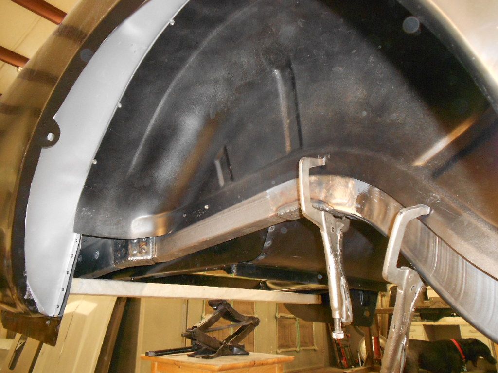

I'm sorry I have forgotten to update
Test fitting the mini tub and quarter
Epoxy primed the inside of the quarters
Installing the DSE mini tubs
Roll bar installed before the quarters
Couple of coats of SPI epoxy
Quarters and taillight panel installed
