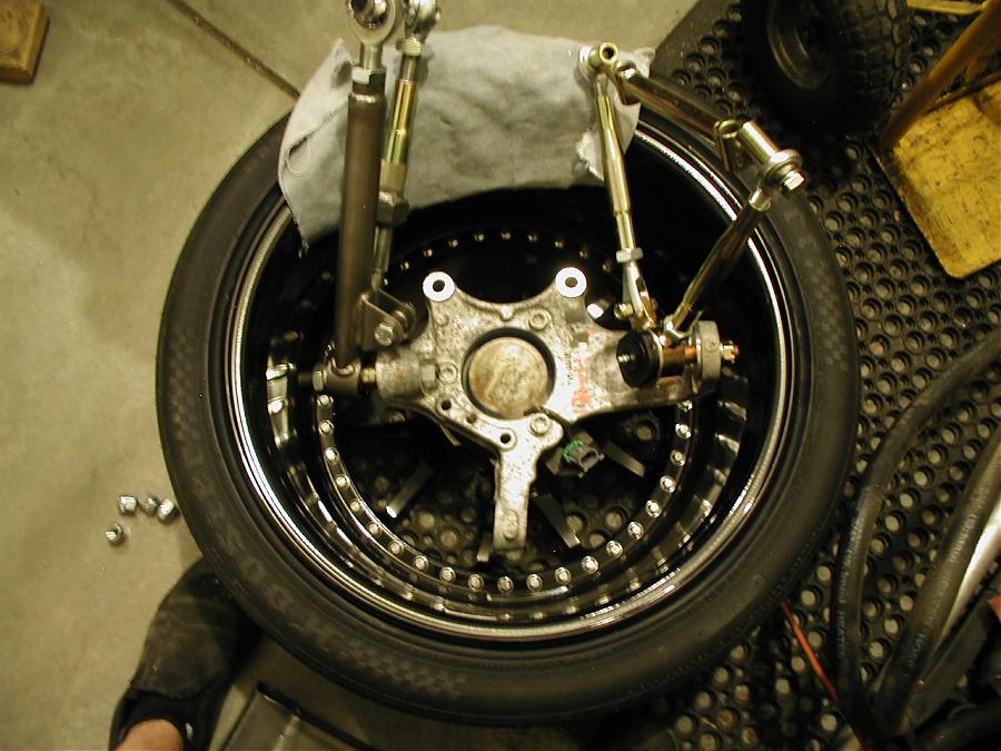

edit - took a break, stepped back from the tree to see the forest, and thought this thru a bit here. I think I have a simple plan to circumvent the funky taper stuff for my project. I can run a Coleman lower control arm with a monoball lower and standard Chrysler K727 1.5"/ft taper, ream the spindle lower to this taper (as this will not open up the bottom diameter which is good), then press out the C6 upper and make an adapter to fit in it for the same 1.5/ft taper, run a Speedway upper A arm assy which takes a standard K772 ball joint which I can get variations from Howe and others. The only "custom" part is the adapter for the spindle upper and reaming which is all pretty cake to redo if I mess up a corner. Whacka$$ taper should then be circumvented. Now to let this simmer a bit and make sure I didn't miss something
How about upper ball joint to wheel clearance?

good call on that - I am going to have to be careful how much stud sticks out of the upper to make sure it doesn't scrape the wheel. The 18s are so freakin' big I feel pretty confident but thanks for bringing it to the foreground of my mind again.

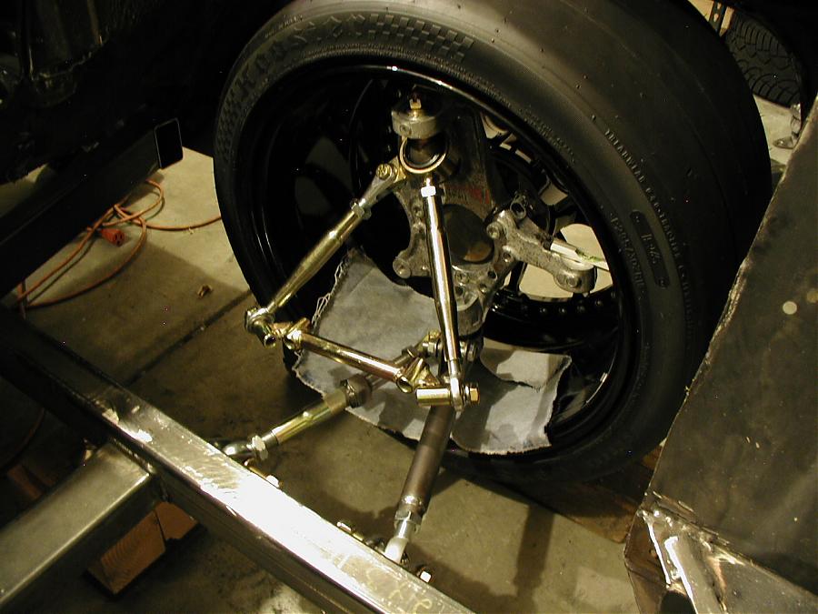

Preston - short answer = yes, I am going to have the UBJ upside down. It does indeed change stock geom by lowering the pivot point, but since I am building a custom frame and pickup points for the Nova I will put the upper A pickup points at the correct height to have the roll center and camber gain that I want.

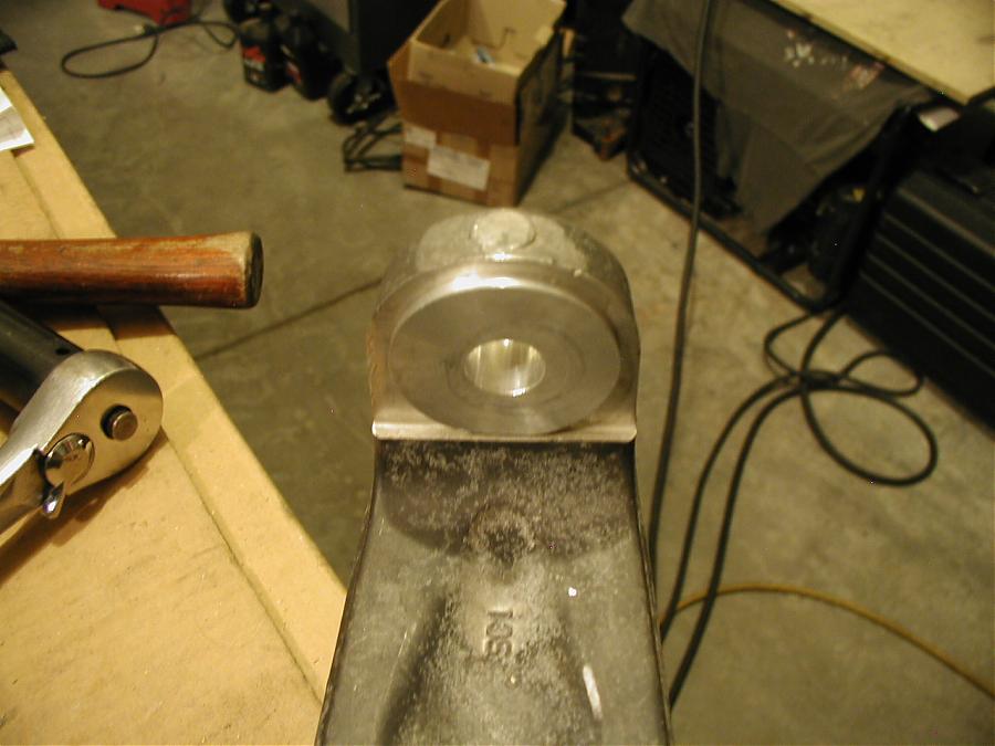

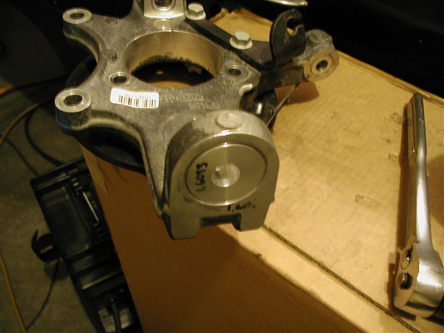

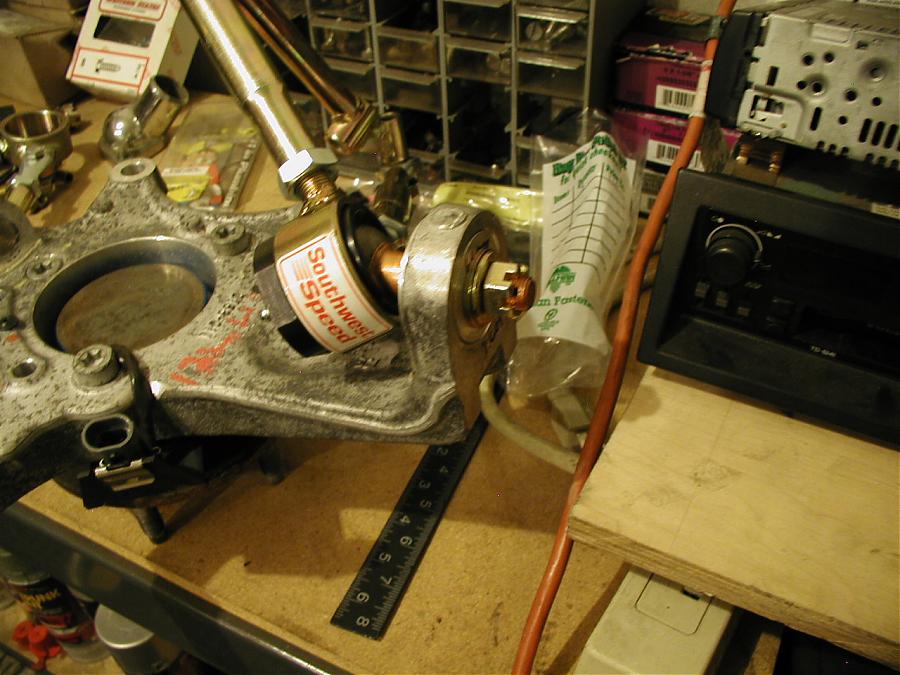

I got the uppers out of the spindles yesterday after borrowing a tool from AutoZone. It will be easy to make a piece to press back in with the reamed taper for the Howe UBJs I have. I got rather lucky, in my scrap alum I had a machined cylindrical piece that I jacked up making and have almost thrown out numerous times - it was exactly the right size to fit around the UBJ and shorter than the piece in the tool kit or the tool would not have fit
That said, in regards to questioning if you could tap the upper, I can say it might be possible but a total PITA to figure out how to do. The Howe upper I have will not slip into the existing hole so it would have to be opened up a bit. Then tapped. That strikes me as a pretty tough item to get square; probably have to build a jig to bolt down to a table on a vertical mill just to get it set up for machining. Furthermore, the material is rather thin around the existing BJ and the overall thickness there is pretty short so getting threads in there and more than just a few strikes me as a bad idea.

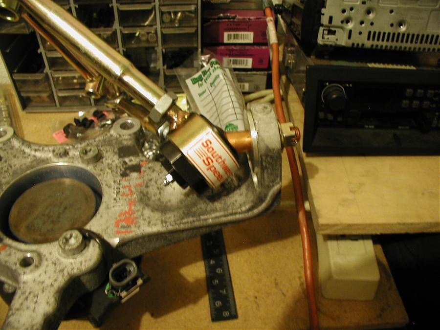

Default ...and to pretty much wrap this up

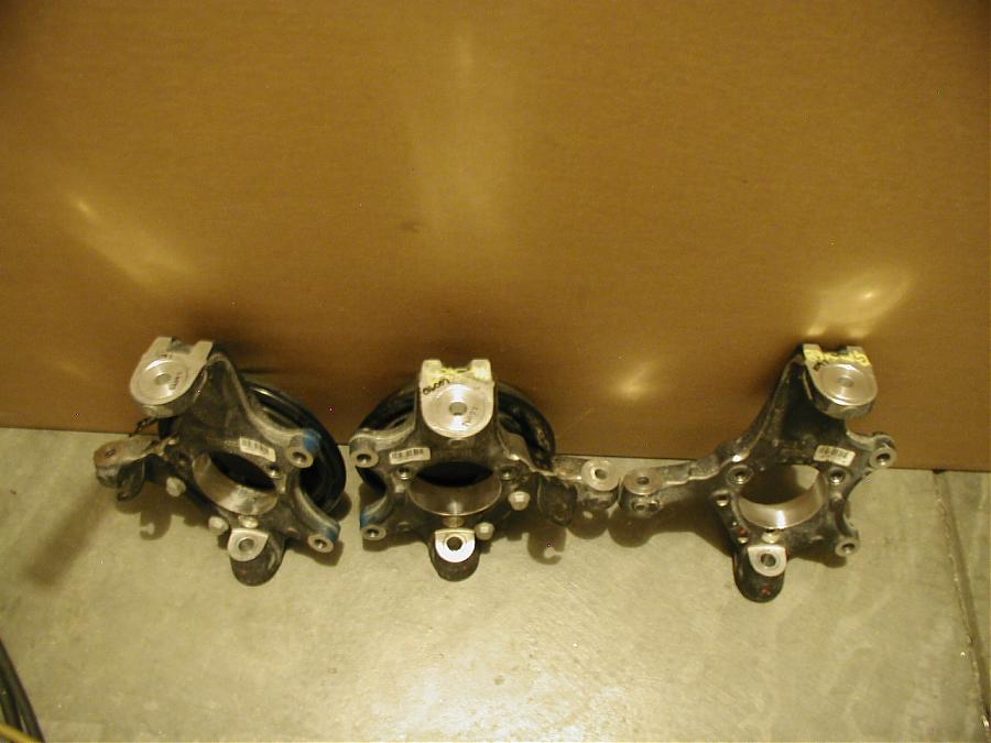

Here are the uprights with the plugs I made to replace the factory UBJ with a tapered, press-fit bushing.

I like it! The slugs press fit -- how much interference in the fit?
