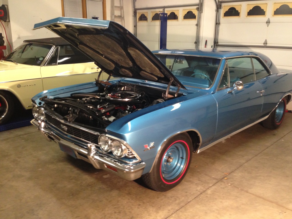

So......Getting Bored and after selling off a few cars it's time to start another project.....I bought a just restored 66 SS 396 Marina Blue Chevelle Factory A/C car.........It's a decent resto but not perfect by any means.......so....the plans are to do the Brake, Suspension, and wheel and tire thingy to get that Pro Touring look ......and the car will never see a cone course....so...it will be a driver and Power Tour car.........Now for the Interesting stuff..........It's gonna get a 2013 Camaro ZL1/LSA 4L90E drivetrain........The factory A/C will be replaced with a aftermarket system from vintage air and the stock interior will be retained..........I know I'm going to have to cut out the trans tunnel and raise it to fit the trans....the end goal is to keep the stock console and shifter for the stock appearance.........Here are some starting pic's of the car......
And here's the engine........It's only got 2100 miles on it
Stay tuned....

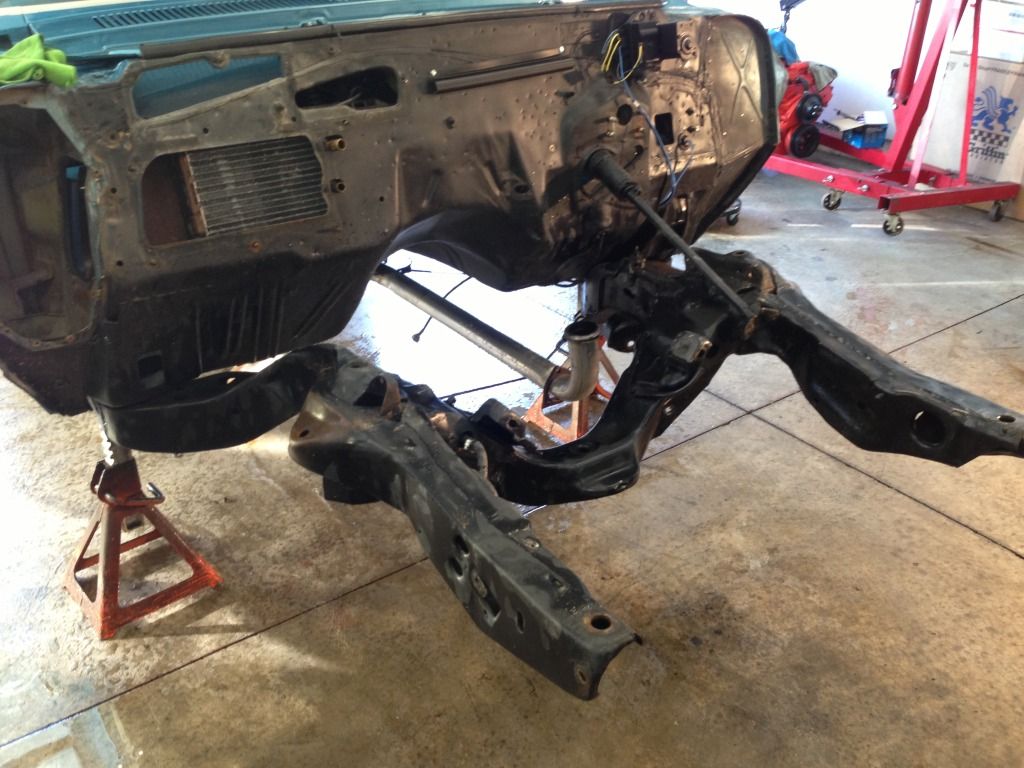

Got the old drivetrain out and we are getting close to starting with the "Fun" part of the rebuild........Gonna find out what fit's.....and what doesn't......Then make it fit.........Everything will be documented here so as to help others in the future.......or.....If anyone has been down this road, feel free to help with any advice.........My biggest concern right now is with the 6L90E trans.........I'm not concerned so much with cutting the tunnel.........But by how much will be sticking down below the crossmember as this thing is huge.......I also did some rough measuring and it seems like the top of the supercharger will be about an inch too high for the hood to close.......But....I'll know more when we get a little further along...

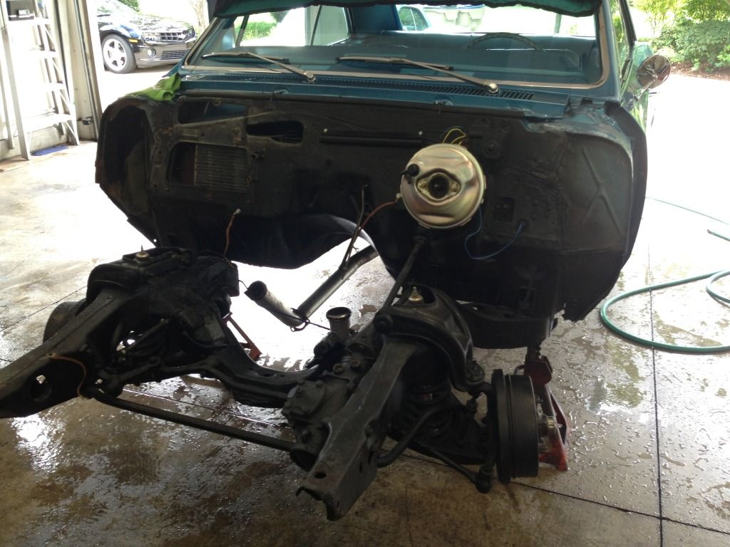

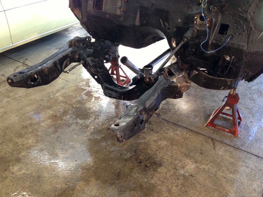

Got a little more done today............Time to clean and detail the frame and get the new suspension and Brakes installed....then get the engine installed.....
