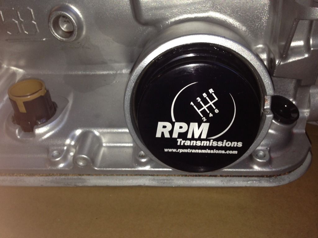

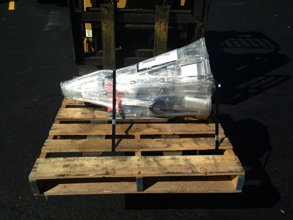

A couple things showed up today......Posi unit and rear axle assy was taken to Chassis Service for rebuilding.........also my Level 6 4L70E trans and converter showed up also.........ordered new brake lines also..........Gonna be a busy weekend

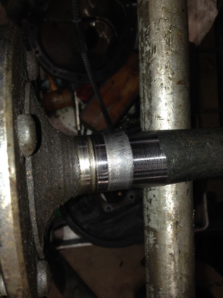

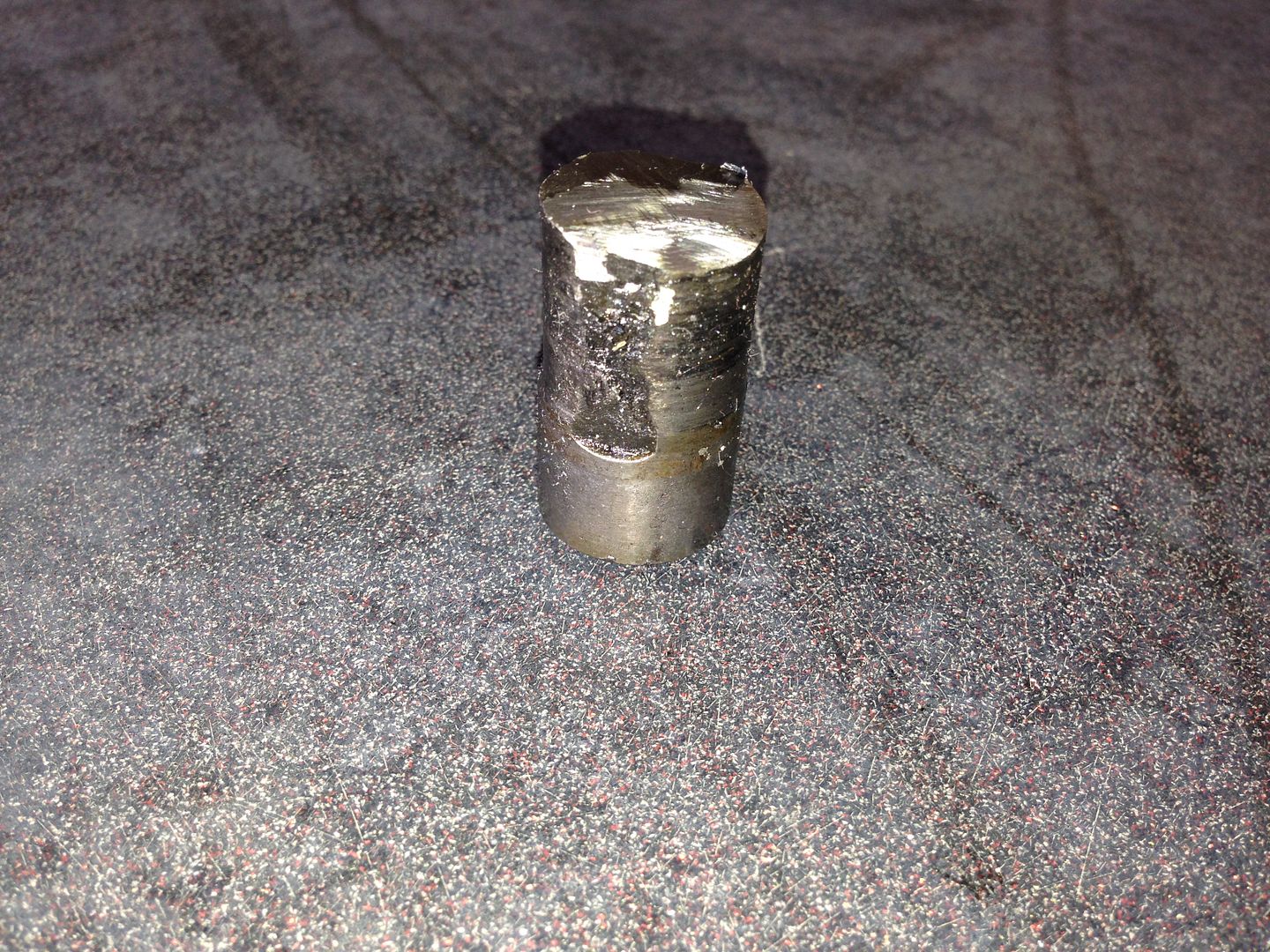

Well......I guess I was Lucky that the car didn't have a posi unit in it when I bought it (if it did I probably wouldn't have taken it apart)
.......After getting a posi unit and dropping the rear end off at Chassis Service for installation........... .........I go over there today and I was shown what was going on in the assy...........In disassembly the shaft that has to be removed to get the axles out was marred and scored so bad it to be cut off with a cut off wheel to get it out......also the rear was filled with motor oil rather than heavy weight oil.......and both axles are shot in the bearing area..........so......New Ring and pinion, bearings , and axles are on their way........Darn$$$$$$$

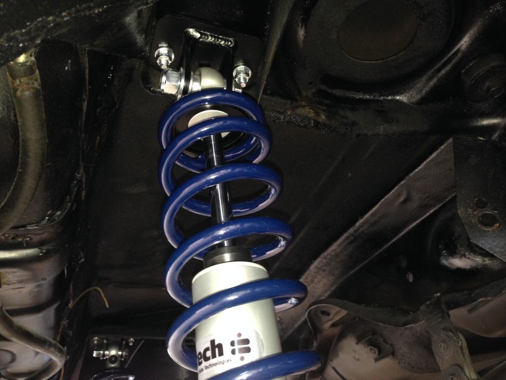

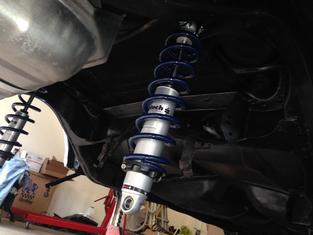

But.....after getting home I got the rear coil-overs installed waiting to get the rear axle assy back next week........

Motor oil?

Default Wonder if the engine was full of gear lube.
What kinda knuckle head would do that?
