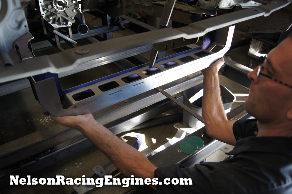

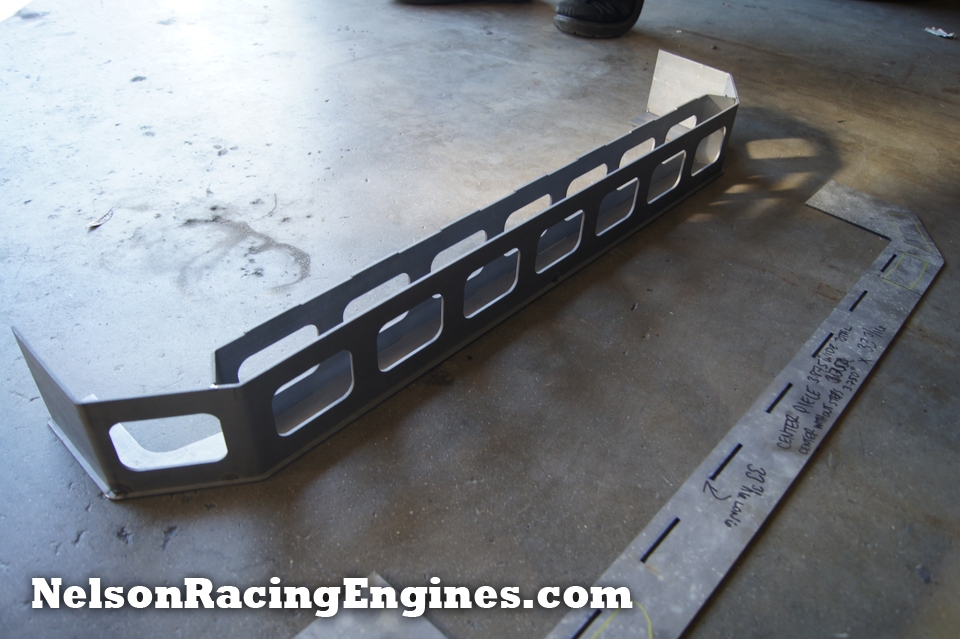

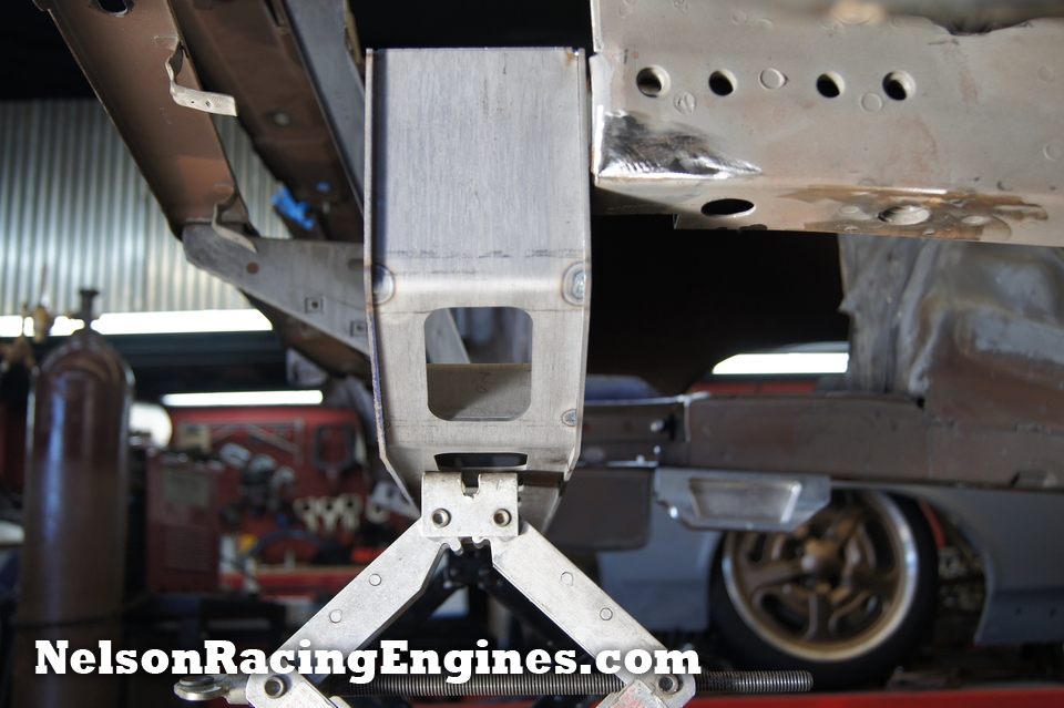

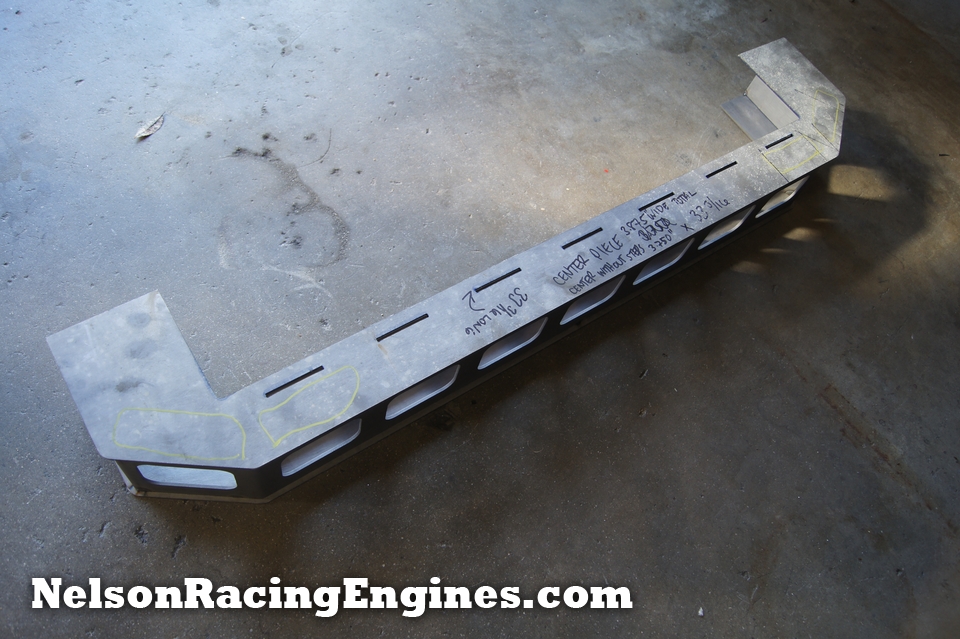

Here is some more of the fab work we are doing .On a Turbo Build like this with a 572 cubic in tt engine there is a lot of heat to get rid of.So we decided the stock core support was no good and to move the rad forward to make room for everything up front also in the past we used to put the intercooler in front of the radiator but it was to much for the fans to pull threw all the ac condenser, thick rad and intercooler or coolers .Then we switched to the water to air type and put them behind the radiator but found they hurt airflow to the fans trying to get by them. So are config now is ac condenser intercooler heat exchanger and we put air to waters in the fender wells.It gives the best air flow .For idling in traffic.So heres the process of incorporating a new custom core support /radiator holder /heat exchanger mount /ac condenser mount
