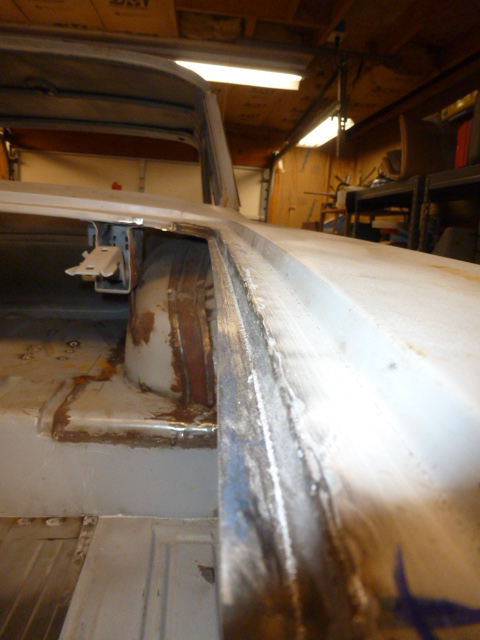

Thanked 7 Times in 2 Posts
Default Mini tubs for an Impala, Biscayne or Bel Air
So, after much researching on how to do these, I was only able to find one source of documentation on how to do these. The source was the Muscle Car show and like all things on TV, there wasn't a lot of details and it looked fairly easy.
Like most things, it wasn't easy and I'm glad I had some help to do these. I would say there is about 20 hours in doing these and if I had to do it again, I probably wouldn't. But, on a positive note I did manage to buy myself a new welding helmet and it's amazing how much better you can weld when you can see clearly.
Since I was back there, I went ahead and did a few other patches on some rust. Hopefully next weekend I can get started on the B pillar and quarter panel. Goal is to have this painted by next May.

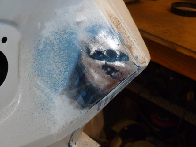

Default Biscayne (Impala) B Pillar and quarter panel repair
Finally got to the part that I was dreading. The B pillar had been hit at some point and whomever the piece of humanity who painted it before fixed everything with a gallon of bondo. The B pillar was a bit intimidating because, the replacement part came with the entire inner window structure and it isn't an exact match for a Biscayne.
After looking at it for a bit, we decided to go ahead and cut out the damaged portion and graft the new piece on the old one. I'm very happy with the quality of the replacement B pillar however, I can't say the same for the quarter panel patch.
The quarter panel patch is a POS. If anyone has to do one for an early Impala, Biscayne, etc., I would recommend going with an entire quarter (believe these are stamped better) and cut out the portions you need. The quarter came out OK, had to add in a piece of metal and some welding rod to fix the door gap and that is still a work in progress. I have a high spot on the back of the patch and a few low spots but, nothing that can't be fixed.
BTW, I'm getting very comfortable with stitch welding and plug welding

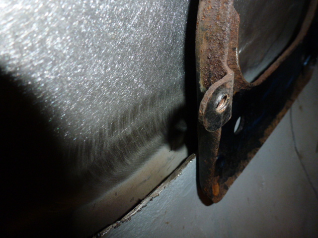

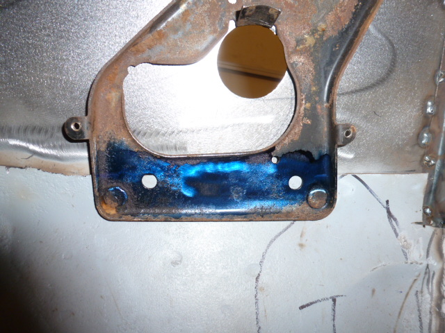

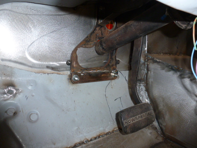

Default Floor, firewall and trunk finished (Impala, Biscayne)
Been kind of slow on the updates. The reason is that I've been busy with a lot of help.
As a result, the floors, trunk and firewall are all finished. Now on to the hard stuff...Fixing dents, finishing the rust repair, sanding, sanding and more sanding. I am extremely pleased with how everything came out and without some help, I'm afraid of what it would have looked like.
On to the pictures.

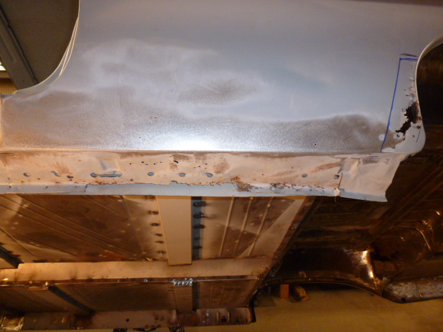

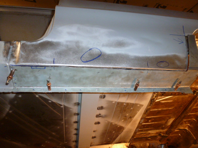

Default Windshield wiper motor, etc.
Nothing too exciting to update on.

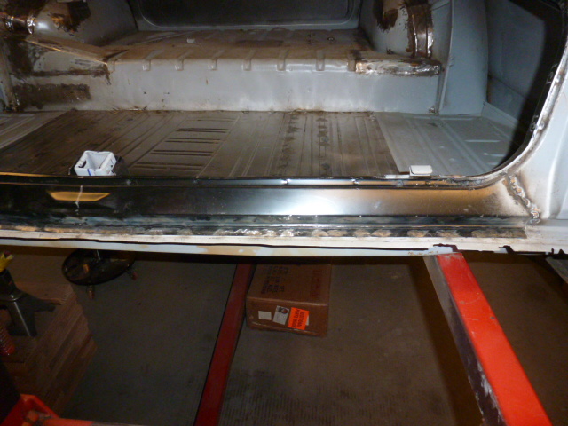

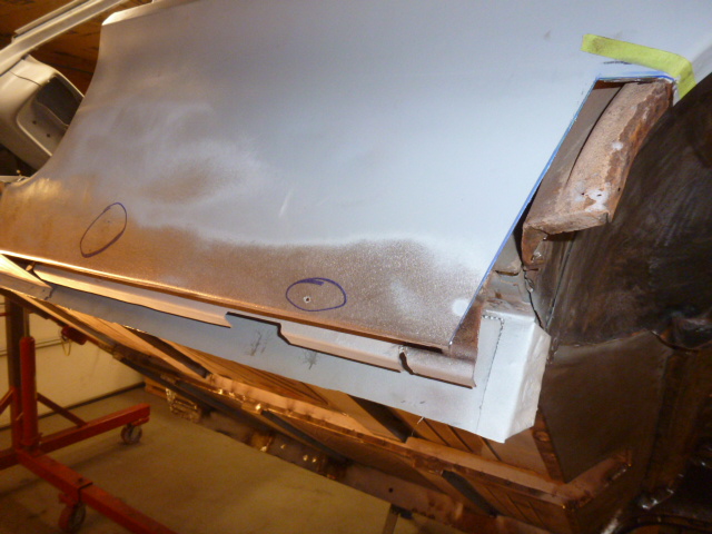

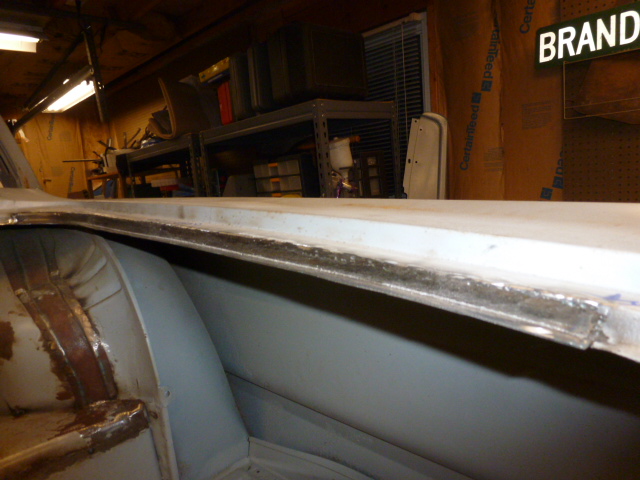

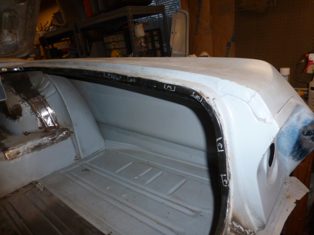

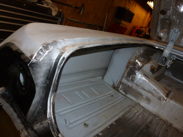

-took the car off the frame and on the rotisserie. To help hold it up, decided I needed to make some cribbing blocks
-managed to fit the late model GM windshield wiper motor
-finished removing all of the rest of the rust and undercoating under the rear half
-re-fitted the center body to frame supports
-capped off all of the floor supports
-made a driver's side rocker patch and welded it in
-welded and capped off the rear trunk supports
-welded in the trunk firewall
-fit and started welding the driver's side quarter patch...Would have finished if I did run out of gas and wire.
As you can see from my list that I conveniently wrote on the side of the car, I have a crapload more to do...Before I have to come up with the next list.
