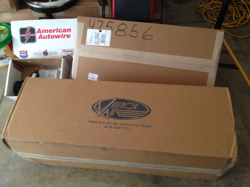

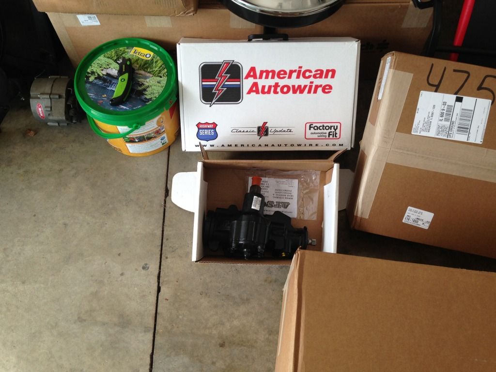

Won't have time to work on the car today ....But....The FedEx guy was still working......The re-wiring kit from American Autowire came in, along with a new quick ratio steering box, and a complete Vintage Air system.....Gonna hit it hard this weekend........
Ken
