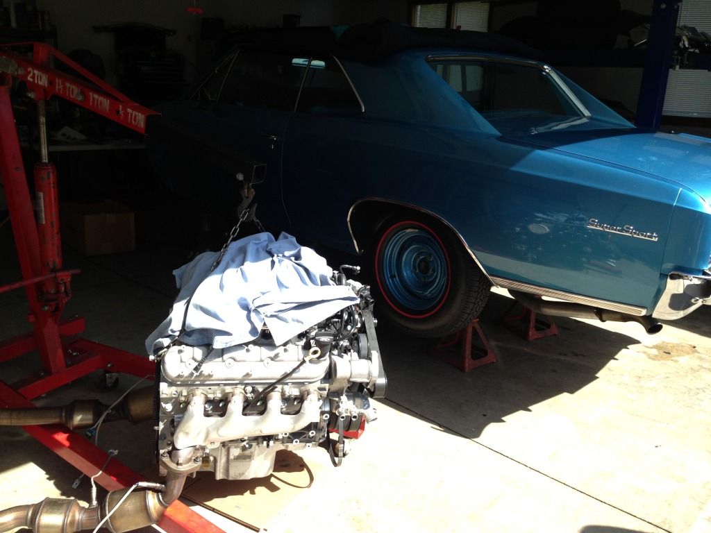

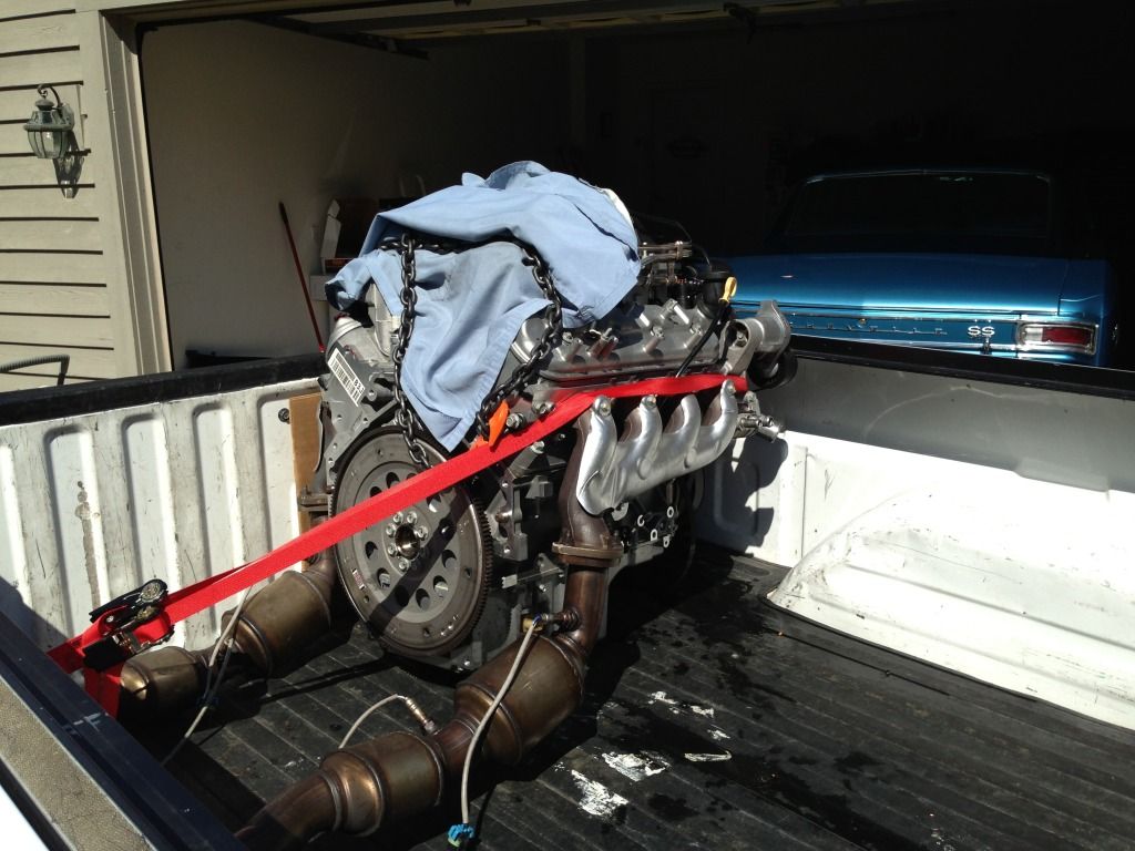

The drivetrain is sold and being re-cycled into another Chevelle...........

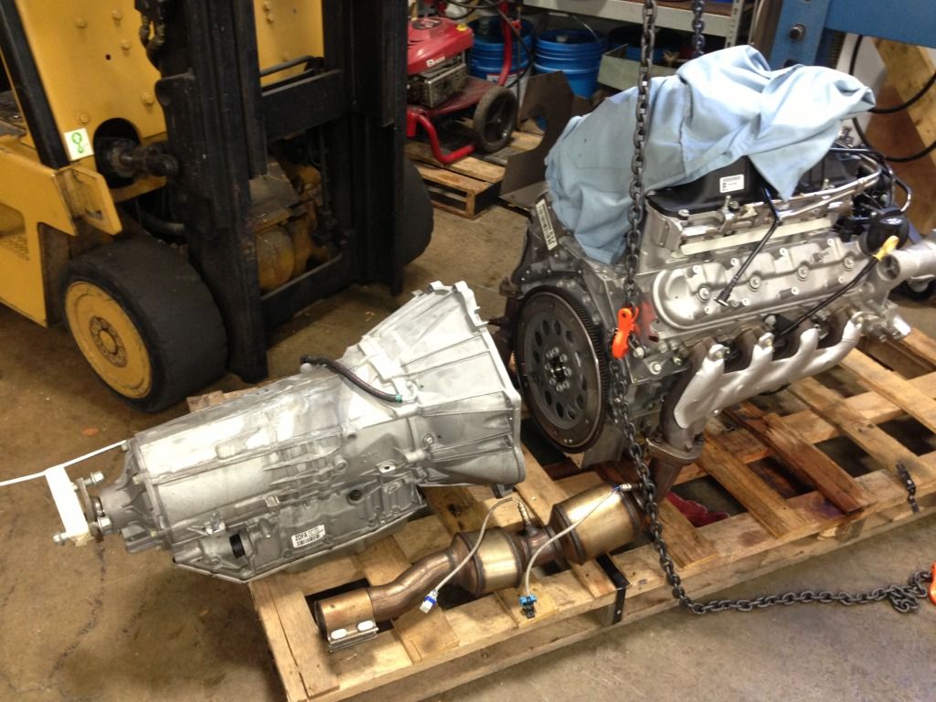

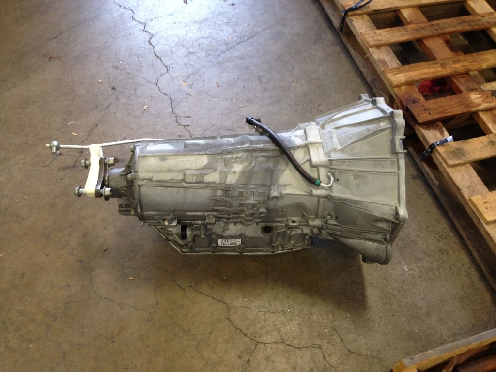

Got the old drivetrain out and we are getting close to starting with the "Fun" part of the rebuild........Gonna find out what fit's.....and what doesn't......Then make it fit.........Everything will be documented here so as to help others in the future.......or.....If anyone has been down this road, feel free to help with any advice.........My biggest concern right now is with the 6L90E trans.........I'm not concerned so much with cutting the tunnel.........But by how much will be sticking down below the crossmember as this thing is huge.......I also did some rough measuring and it seems like the top of the supercharger will be about an inch too high for the hood to close.......But....I'll know more when we get a little further along...

A couple of things happened today.........The original drivetrain is now gone and on it's way to be installed in another Chevelle and to live another day................And.....After looking at the 6L90E trans and measuring everything.....I'm just not comfortable that the trans pan will be high enough for me to drive the car comfortably worrying about that pan hitting something as the car will be a couple of inches lower than stock with the Ridetech Coil-over suspension.....So.......I'm going to buy a built 4l60 trans that will fit without the trans tunnel surgery and pan issues......I need to resolve some issues but John at Speartech has said there wouldn't be any communication issues with the computers .....so....looks like that's the way I'm going to go......(That's today's plan anyway.....LOL)
