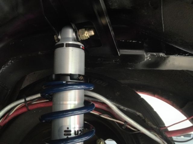

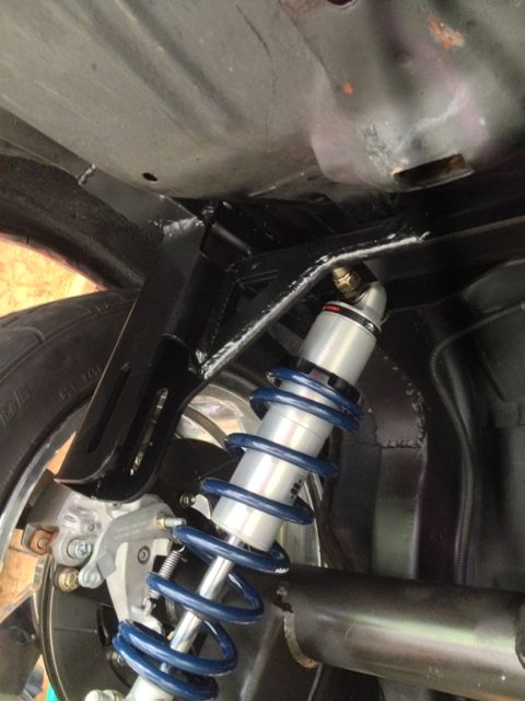

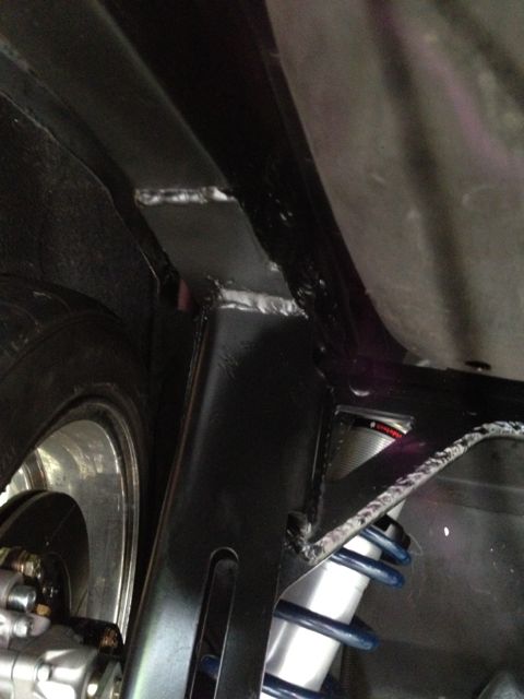

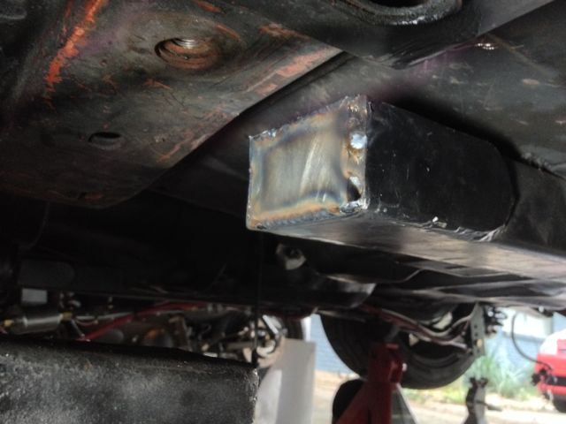

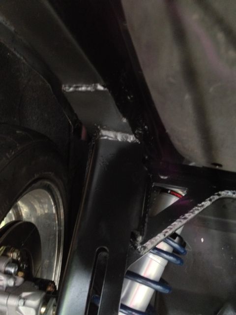

Cleaned up the plates I'm using to box in the frame and started welding them on. Work's been a bit nuts so I'm way behind schedule. Despite being behind I'm still trying to take it slow and easy to get it all right the first time.
Even while trying to do it right I screwed up a little. I wanted to drill holes in the 1/8 plate so I could also plug weld (think that's what it's called) it to the existing frame so its not just held by the outer welds. I remembered on the lower plate but not the upper. I'm going to carefully drill some holes mostly thru the plate then weld it up. I assume with the correct setting the weld should still penetrate and bond even if I don't drill all the way through the plate.
I think I've also decided to swap out the front brakes to a 13: 6 piston Wilwood setup including a 7/8 master cylinder. Mike @ Wilwood is working with me to get the parts together. It's beyond my original budget but I figure it's best to just get it all done right the first time.

Oh, and this time I'm open to any feedback about my welds. I did my best to be patient and keep the metal clean but I'm still trying to figure it all out.

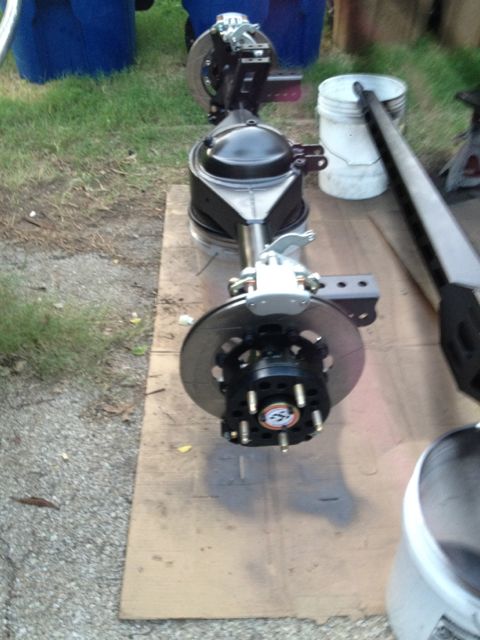

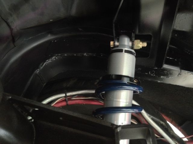

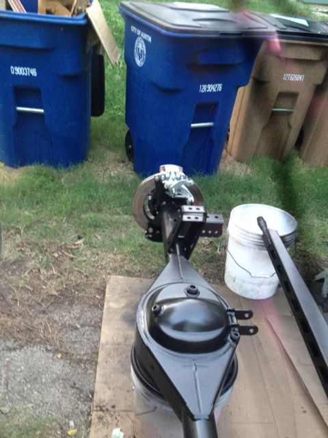

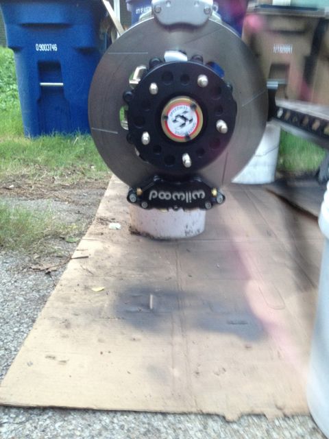

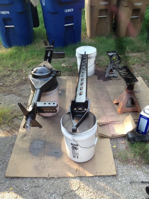

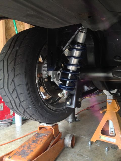

The project is moving along, just slowly due to work. As of today I have the full suspension mocked up. Lots of work was need to get the front x-member in due to the Detroit Speed subframe connectors and the lowered body mount. I had to cut the frames apart in order to get the x-member in. Now I need to add some plate to reattach the frames again but this time the front side will be welded and the rear will use a couple thru bolts. I'll try to get a few more pics but here are a few bad ones I took while working.
