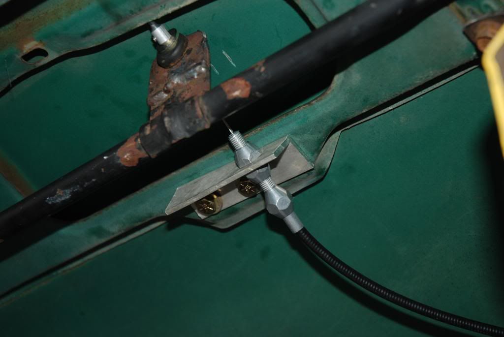

As you may recall, I had to modify the hood latch mechanism to clear the new radiator placement. I purchased a hood latch lever and cable system from Lokar and installed it. Works like a champ!
I was able to modify the original hood latch lever assembly to use as the bracket for the new lever assembly.

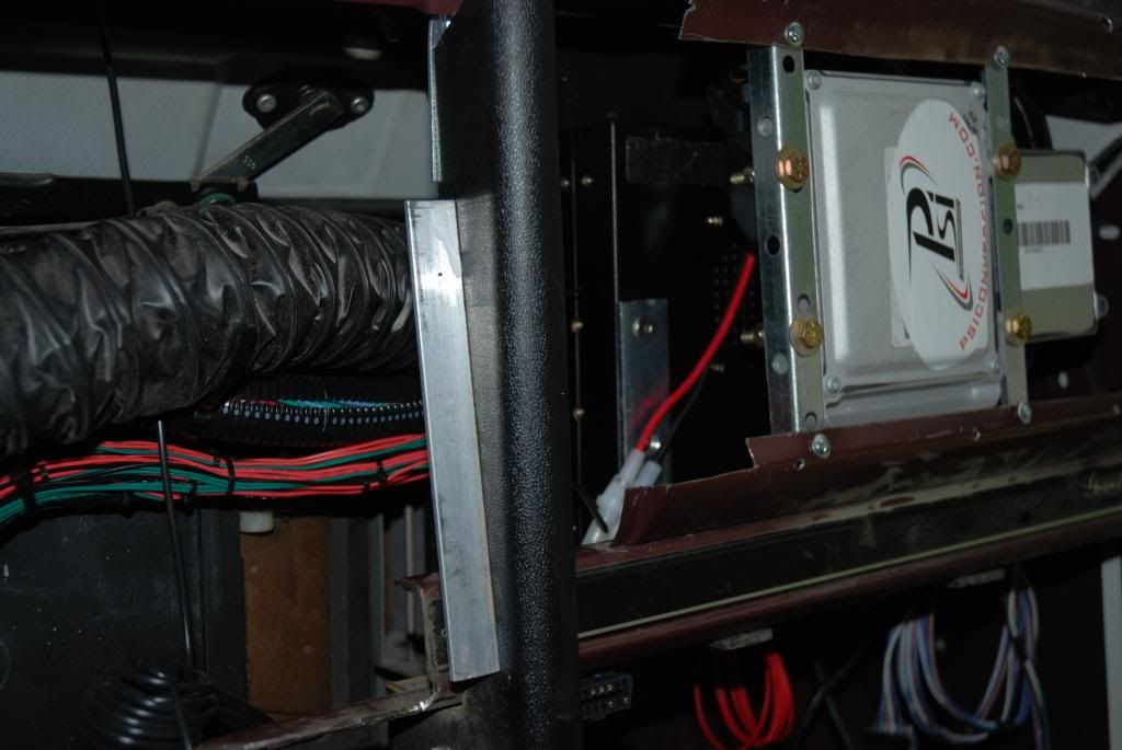

With the new heat-A/C system, there is plenty room up behind the passenger side of the dash. A few brackets, and some careful measuring, and we have a place to mount the ECM, TCM, Engine Management Fuse Panel, Auxiliary Fuse Panel, CB Radio, Remote Start Module, Keyless Entry Module, and... I think that's it... maybe...

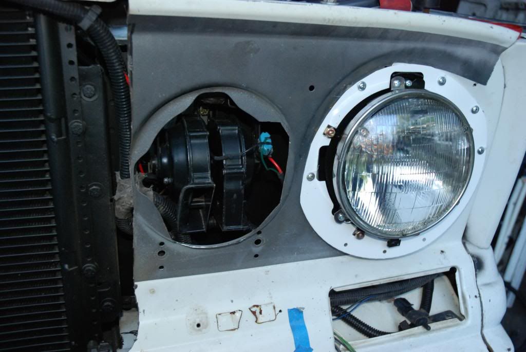

Under the hood, I mounted the Fan Control Module.

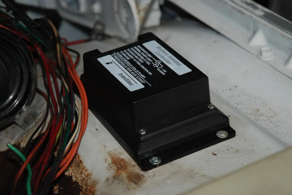

And the Auxiliary Battery Control Module

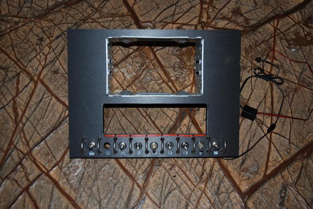

In between migraines and other assorted distractions, I finished the radio panel. The upper hole is for the head unit w/GPS. The bottom is for the CB radio face. The toggles are for all manner of stuff. I have different labels coming as I don't like the way these look.

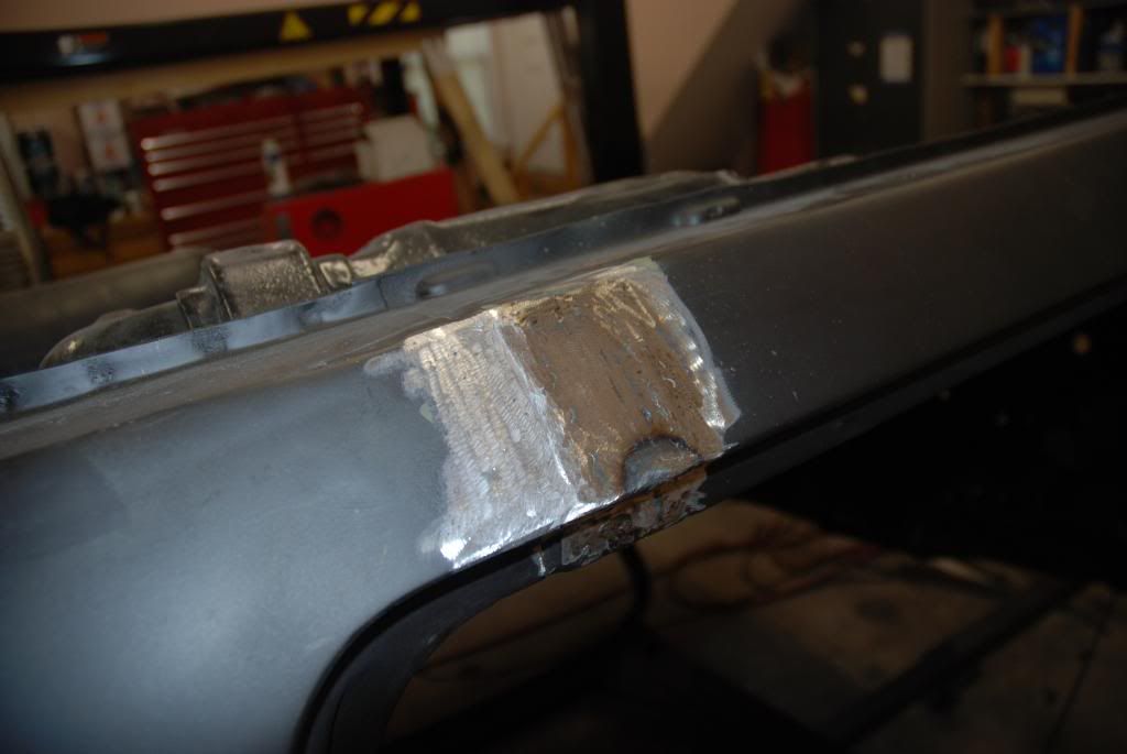

Rocker panel repair.

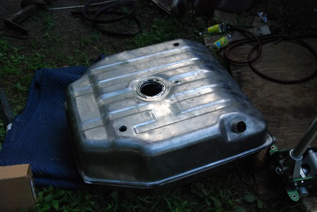

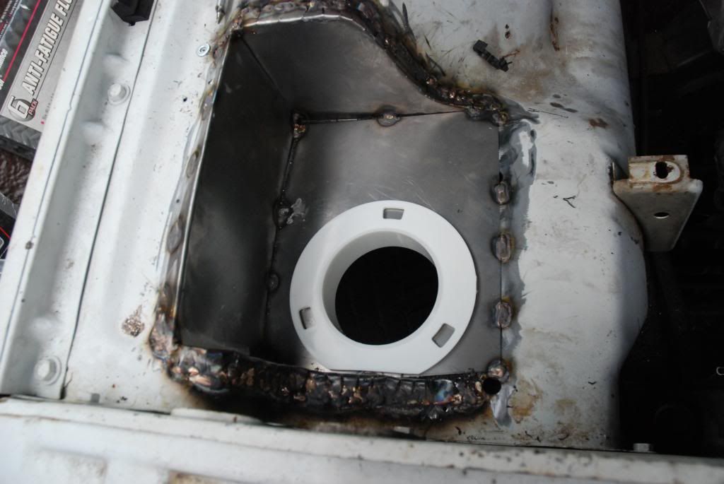

Behold! The Infamous 42 gallon Suburban fuel tank. So how do you put 50lbs of manure in a 25lb bag? Well, fist you remove anything that sticks up from the top of the tank. On the Suburban tank there are two vapor vents (for the charcoal canister) and a vent for the fill. The vapor vents were filled with freeze plugs (turned down to 1.22") and installed with JB Marine Weld(fuel resistant). The hole for the fill vent (it was already torn off when I bought the tank-got a deal because it was damaged) was filled with by tapping the hole to 3/8 NPT and screwing in a plug coated with the same JB weld. I then made a new vent next to the original fill by drilling a 1/4 hole and enlarging it with a tapered tap (to make an area for the tap to bite), tapping it 3/8 NPT, and installing a plug.

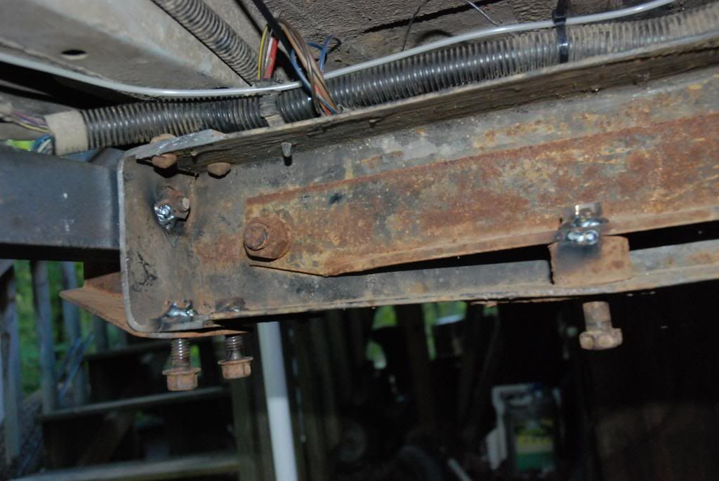

As others have done, I cut the rear most crossmember off to make room. Sine the tank will block access to the nuts that hold the bumper and trailer hitch, I welded them.

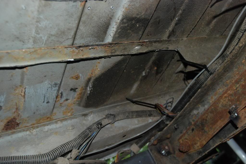

I had to trim the floor brace so I could get the tank as high as possible.
While under the truck, I installed my new air shocks. I drilled a couple holed in the crossmember located just behind the rear axle to hang the tank mounting bolts.
I braced the rear of the frame with an L brace (to hang the tank) and a larger brace attached to the bumper brackets. Here is the L bracket.

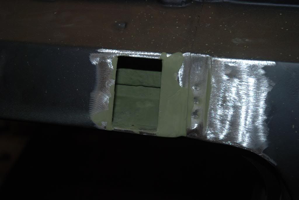

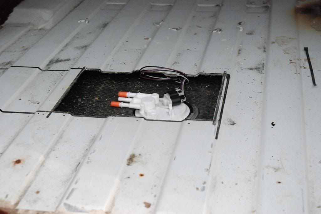

A hole was cut in the floor to make easy access for the fuel sender/fuel pump unit.

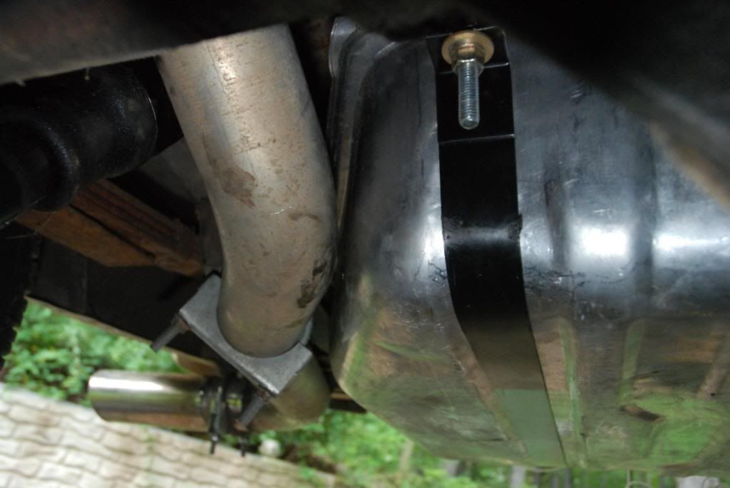

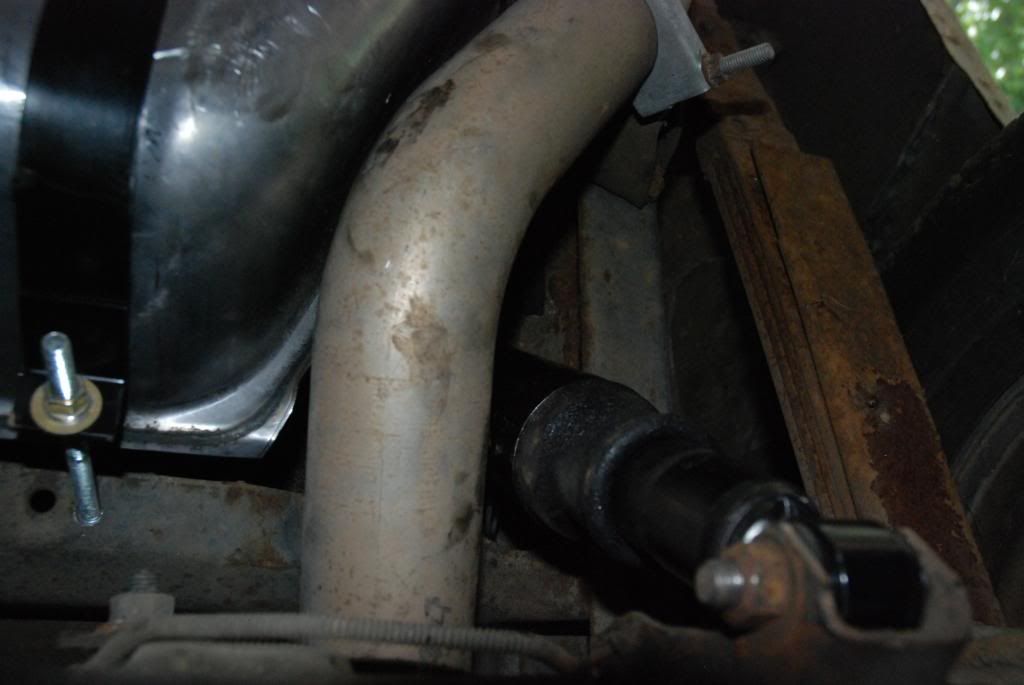

The exhaust passes between the rear shock and fuel tank with little room to spare. Currently there is about 1/4" between the exhaust and each item.
Here is another view. Once done, I'll take it where I can get it up on a lift so I can dimple the pipe and the tank to give about 1/2" between the pipe and the shock, and a good 1" between it and the tank.

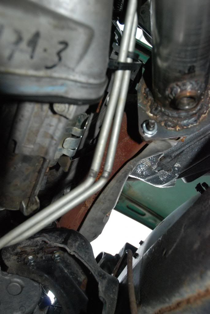

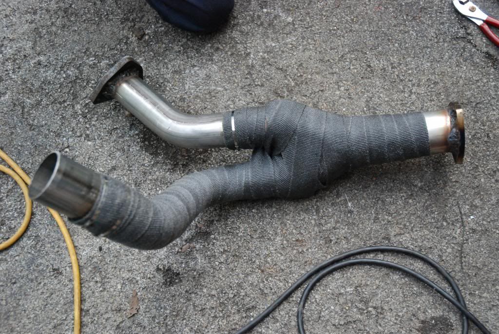

Since we were working on the nether regions, the headpipe was next. Using the Silverado manifolds, I welded up a headpipe with crossover. The welds aren't the prettiest, mostly because I was welding stainless with a MIG. Still, I got good penetration, and that's all that matters.
The pipe is in two pieces with a sliding clamp to ease installation. As it runs very close to the transmission pan and servo cover, I wrapped it. This will also help keep heat out of the interior.
You can see how close it runs to the pan. There is good clearance for driveshaft movement too.
I had to cut the original floor heat shield for clearance, so the wrap will really help.
Here it runs down past the transmission. There is a shield that also protects the transmission from the heat.
Passenger side clearance. Good distance between the exhaust and the starter.

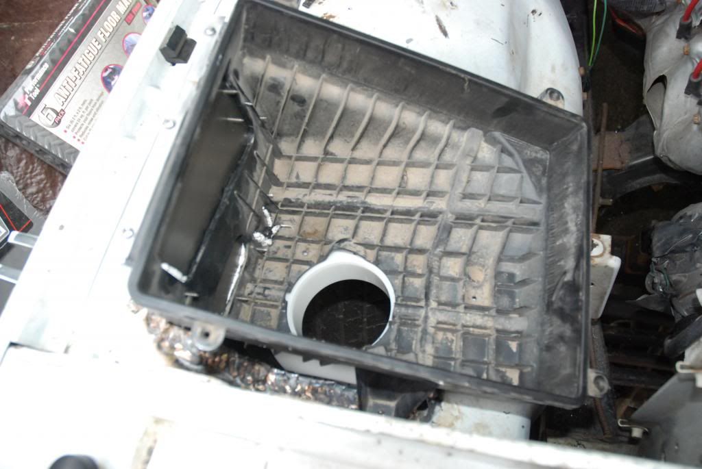

Made a place to hold the Chevy airbox. I cut a 4" hole in the bottom of the airbox, and made a tube to connect behind the front fascia.

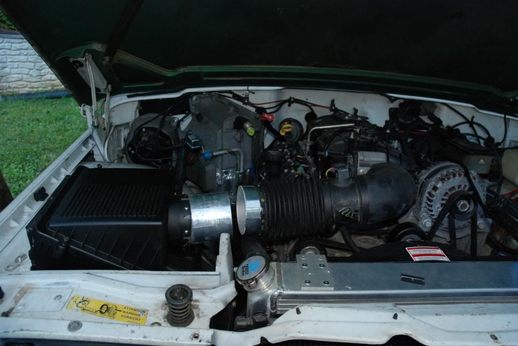

Modified the airbox to close off the original air intake and instead use the new 4" intake tube. By the way, the welds are Silicon Bronze. Nice stuff to work with! Not for anything structural of course, but great for working with sheet metal.
A test fit with the lid.
Finished, except for the last flex joint and clamps.

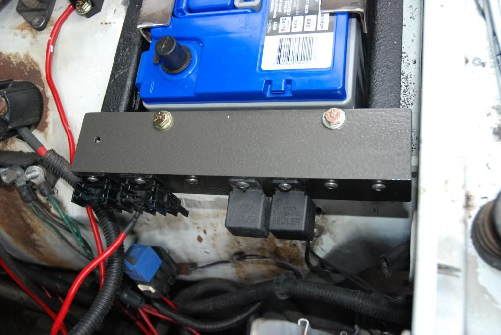

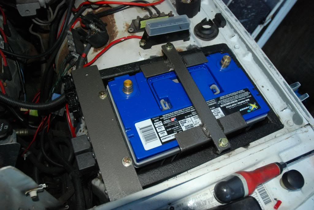

I forgot to take photos of the build process, but here's the battery box (built out of the bed frame mentioned in the other thread).
I also made a bar to hold 3 Maxi Fuse holders and 4 Bosch style relays.
