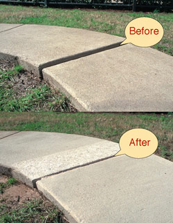

http://www.saberfoundations.com/concrete-grinding.html

Concrete grinding is great for public sidewalks and such but would look horrible at your garage entrance. Judging from the picture you posted I'm going to assume that all the houses in the neighborhood look the same where the driveway meets your garage slab? Not sure why.....it's not typical......at least where I'm from.
