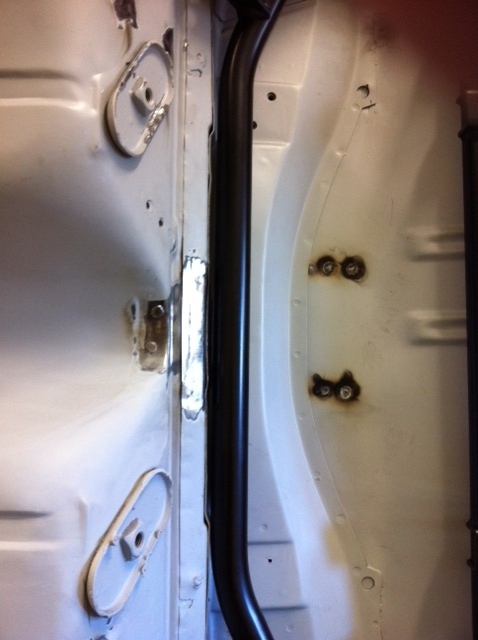

What did everyone do with DSE subframe connectors when routing the fuel and brake lines? How did you cross over the connector? Did you fab a channel into the connector or did you just route them over the it?
Also, my Ridetech Airbar on one side has a mm of touching at the back of the floor pan and the other side is about 1/8" away from the back of the floor pan. This is where the forward tube crosses over from frame rail to frame rail. Will this be sufficient or should I address this?

well i had the same issue but because i'm mounting my master cylinder inside the dash i decided to run my brake line inside the car....i just mocked it up so far but will post some pics shortly... the way you have it mocked up looks fine .....keep at progress is looking good
