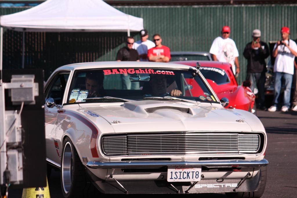

Great job this past weekend! Wish I could of made it.
That picture above with the hood hinges pushed down makes me cringe.....I did that on a 75' pickup and had one pop up into my face. Luckily it hit above my lip and only required a few stitches at the hospital. I could've lost my eye over that.
same thing happened to me, right in the cheek and ear. they are hooked and have low tension springs that dont pop till they are up a bit.
