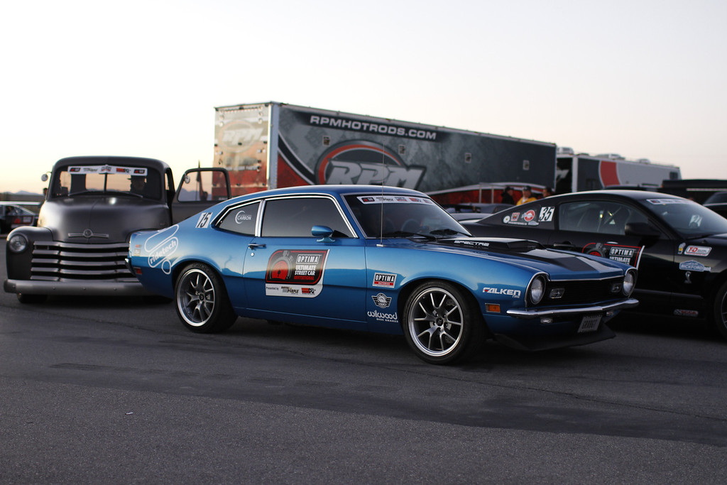

Thanks Sieg. I used this one on my Facebook page.

Carl it would be an honor. If you need larger images, pm me your email and I'll send you the links.
