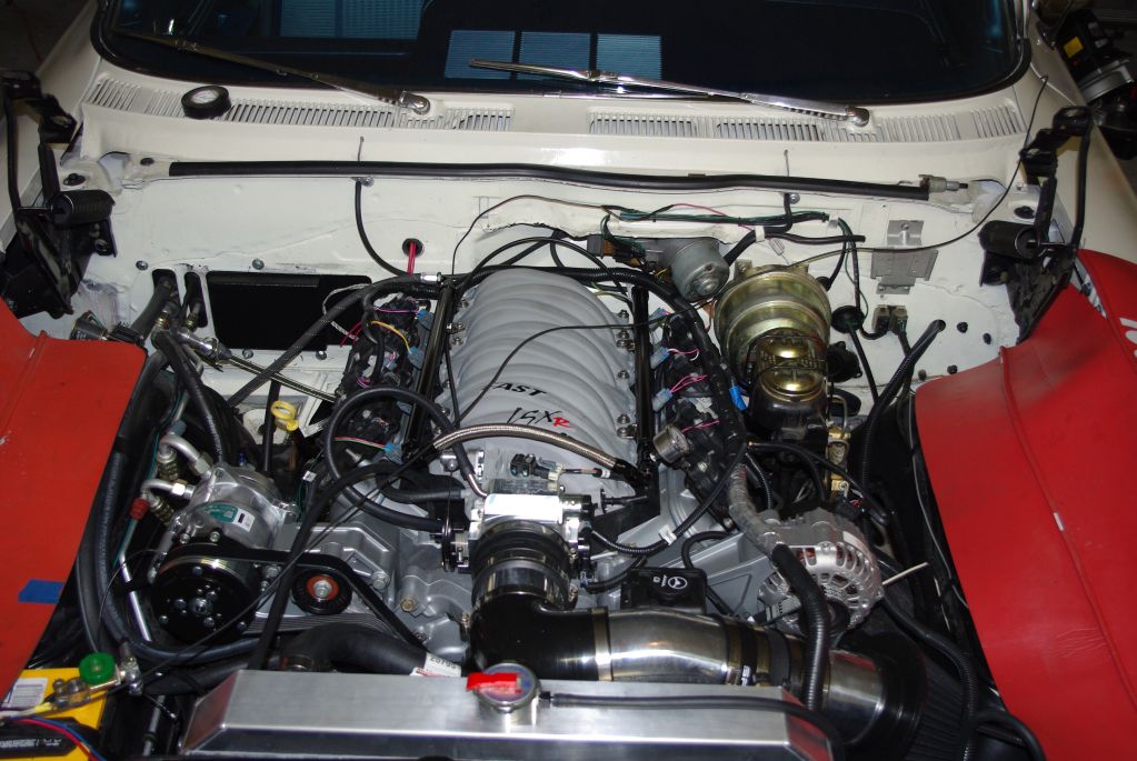

What a week, lots done and so many high points. Sounds mean with open headers and the asa cam. Made a video on the iPad of the start up but for some reason it's not uploading to photobucket. Any ideas on what it takes to get that loaded let me know.
Got the intake dabbed up, probably will paint it all black with dei sound deadener, like the Kringle finish on that stuff. The engine bay will get some major attention to detail, I just started throwing wires and hose on so it could be started. The only thing that kept me from taking a quick spin was the computer was still sitting in the front of the engine compartment loosely on a beach towel.
Bought some PVC to help me route the first part of the exhaust. X-frame low riders can be a little tricky to get from inside the frame rail to the outside of the frame, but this really kept the waste to zero by playing with PVC first.
Still have lots to do, but now that it's running I will work at a much slower pace and enjoy the journey.
By the way, LSXRT's will not fit, that was my screw up. Need to put that on ebay, had to fed ex the Lsxr into the house for Saturday delivery. Whoops!!
