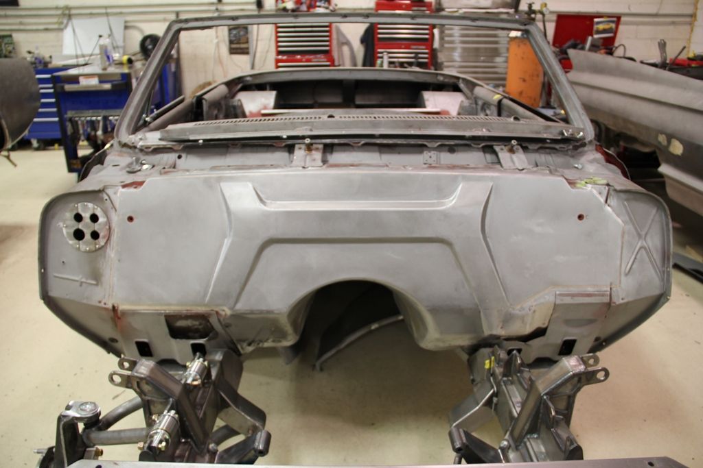

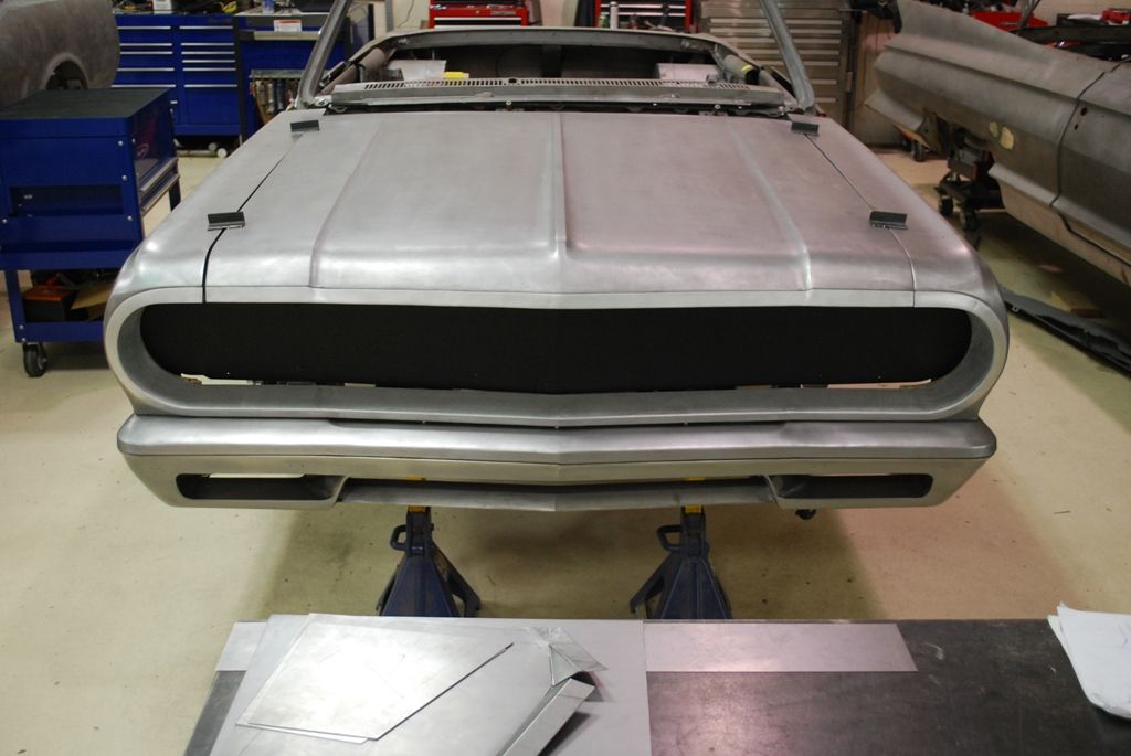

We have been very busy with Tim's 64 over the past few months. Here is the picture recap of what we have been up to.
Finished up all of the metal work on the nose of the car for now. Headlights and grille still to come.
Trans and driveshaft tunnel for the 6L90

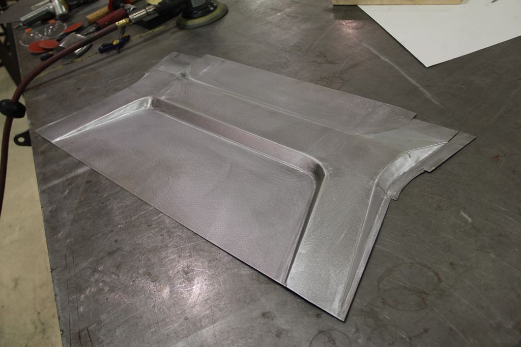

Wanted to try something different than the standard smooth or bead rolled look for the firewall so we fabbed this up.
Removed the stock piece that looked like it was blasted with a shot gun
And welded i the new panel.
www.roadstershop.com

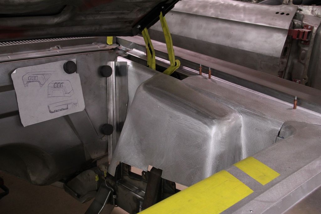

Here is a look into the engine compartment and how it was built.
Rough mock up and initial panel fabrication.
Close out panels around the radiator
Added some indentations around the mounting hardware and the new hood latches.
The completion of phase 1 of the inner fender...

A few more pics of the underhood fab:
Adding some detail recesses to the inner fenders
IMG_7547 by Roadster Shop, on Flickr
Picture 315 by Roadster Shop, on Flickr
IMG_8674 (2) by Roadster Shop, on Flickr
