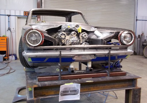

Here are a couple of more pics and I will be posting up some more soon.

Why did you cut it in half?

The reason for cutting it in half is we wanted the car to look more aggressive and have better proportions. These car are really narrow and really long, so we wedge cut the roof 2 inches and instead of leaning the A pillar or lengthening the roof we decided to shorten the car 2 inches behind the B pillar. We also stretched the wheelbase 2 inches and that will allow us the move the front wheel opening forward in the front fender 4 inches to make the overbite go away.

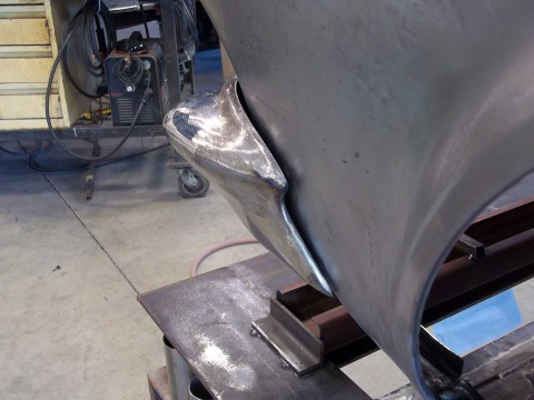

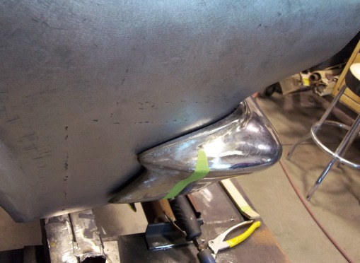

Thanks to Brian Stupski for the killer job on the front end design. The front bumper is boxed on the back side and so the openings supply air to the air box witch will be located on the drivers side under the headlight.
