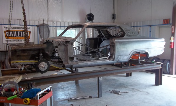

Here are some more pics. When we cut the inner wheelhouse out behind it we found where an unhappy assembly line worker had been. On the inside of the quarter panel they had wrote a 4 letter word in the rubber coating sprayed on there by the factory. We got the body stuck back together and the front wheel well cut out and playing around with the placement of that.

The guy that is doing the work on the windshield said he was just going to grind it. We are not going to be using the stock rubber so it will only need to be ground down about a 3/8.

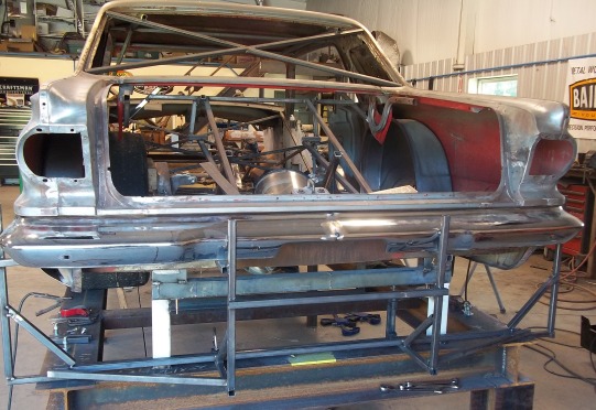

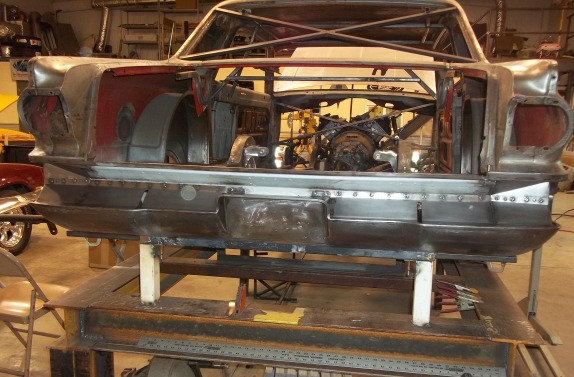

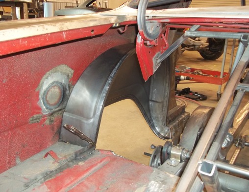

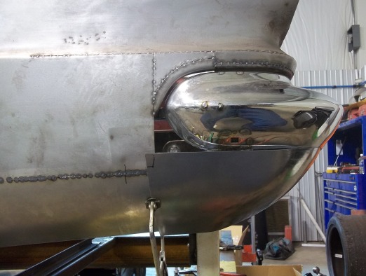

Here are some shots of what we done to the rear of the car and some wheel tub work as well.
