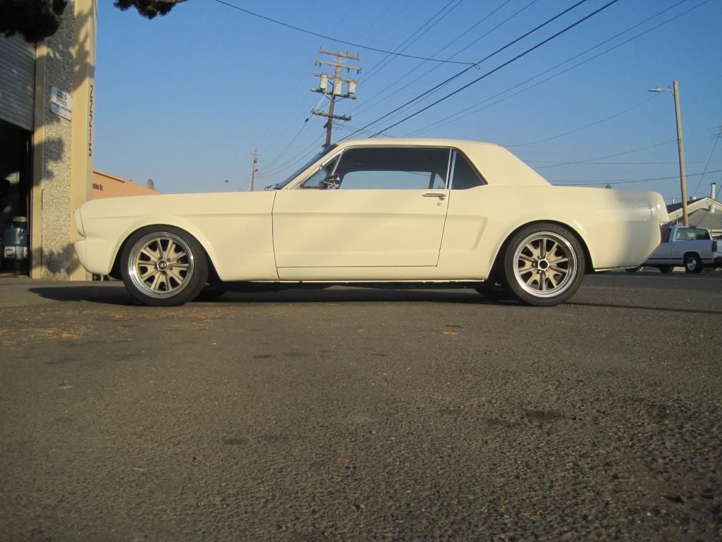

Lowered some more and put some new/old set of wheels on.
17 x 9's on the front with 4.75" back space and 17 x 9.5's on the rear with 4.75 back space.

Really cool build. The fender flares really set it off, they look great. I like the retro Trans Am Series look too.

Nice, so it was your car posted on the Maier racing FB page the other day.

I love this car. You really did a great job with the body work and especially the flares.

Nailed it!!!! the stance is perfect man! this makes me want to get mine done!!! just need to quit spending money on everything else, and focus on my mustang.

nice looking car with a great stance

perfect looking coupe - love the color.
