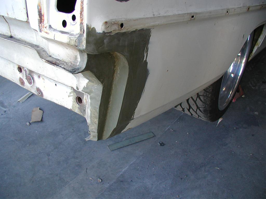

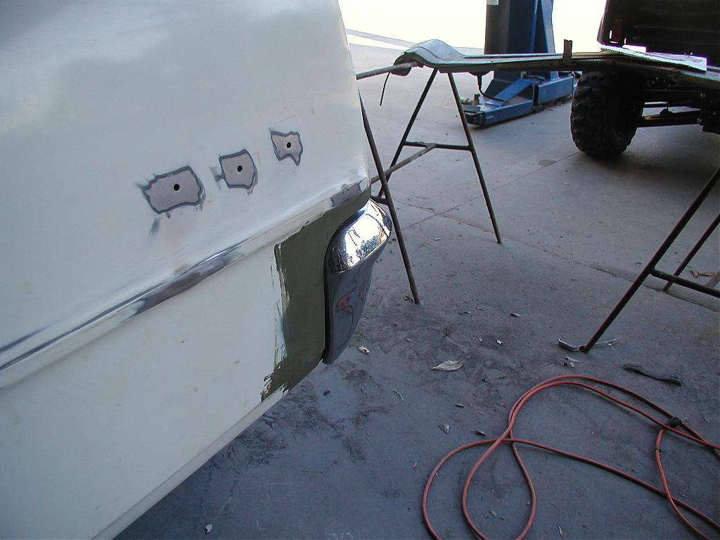

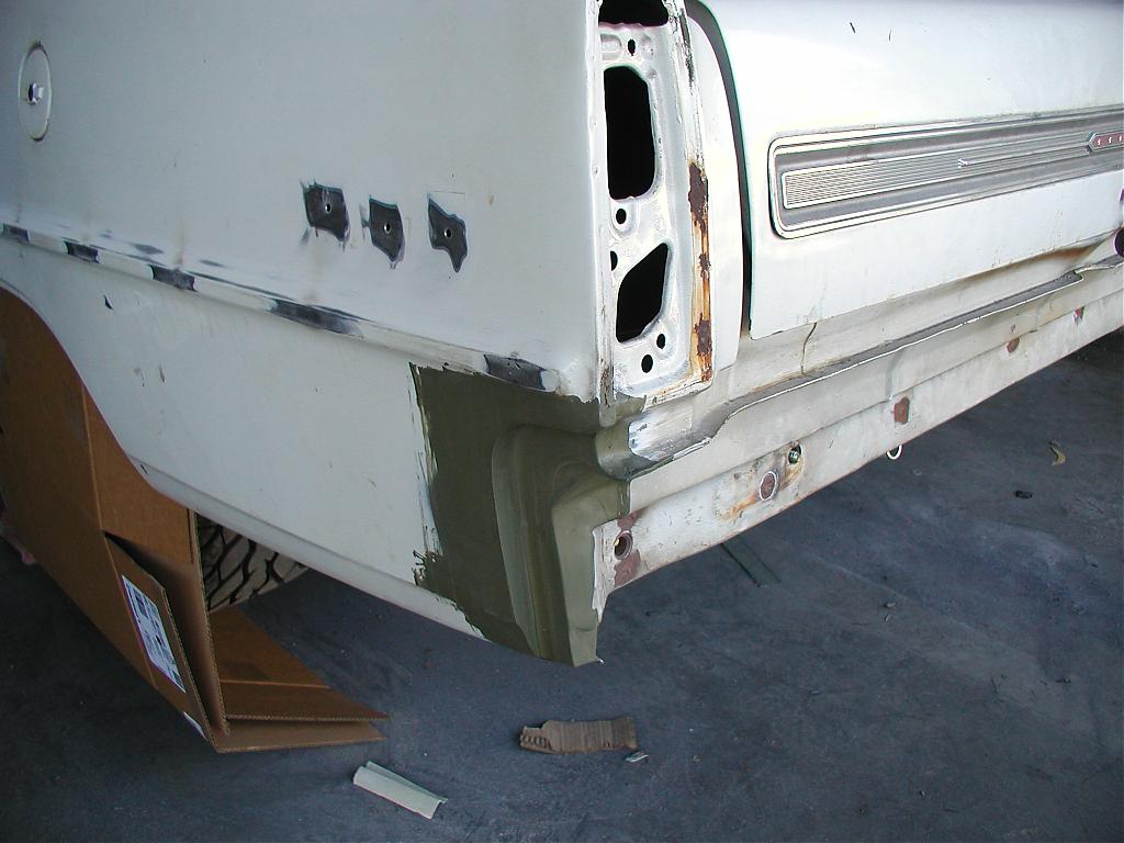

Here's a few pics of the rear bumper mods.

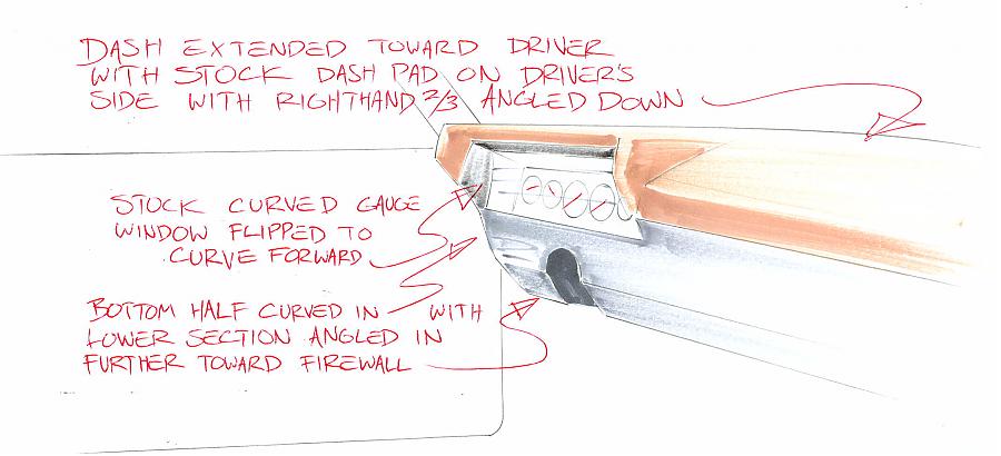

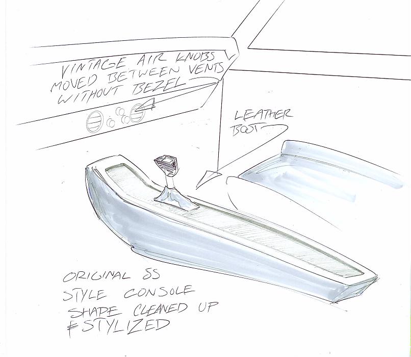

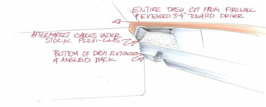

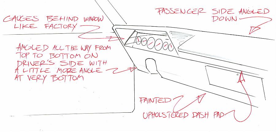

I would like to bring this thread back from the dead. The car has taken a long time due to my construction business being slow for me and a long drawn out divorce, therefore there was a shortage of money. It is drivable, but still needs a lot of work. I'm going to post a few pics of it's current condition and some renderings of a possible dash and console.
I still have many questions on how I'm going to proceed, because the advances in these cars go so fast due to the fact I've taken so long to build the car. Any comments or suggestions would be appreciated.

Not sure on how to advance the styling of this car, but the dash looks good to me. Subtle and classy. That dash and console design, in my opinion, looks like it can withstand the test of time. It's no too flashy where it would look dated in a year or two. I like it. Also, glad to see you still have the car thru a divorce. I have some friends who got divorced and the spouse neither wanted the car nor knew what to do with it. They just didn't want them to have it and knew it would hurt them to take it.
